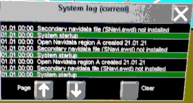

Rainier,
The attached error log continues to appear during power on mode and continues to repeat so unit will not operate.
I am not sure why the program is searching for the SNAVA.ewd file (which I did not request) and causes a fatal error.
Torrance reloaded the internal firmware; e a software prblem but I will try to make the fake files to see if it will go away.
Thanks.
Thanks.

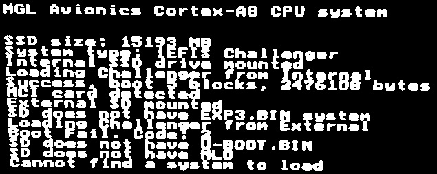

- Final Screen Message before error repeats
- Screen message.jpg (7.58 KiB) Viewed 4119 times
- System Log- Can clear it but keeps repeating
- System Log Display.jpg (46.6 KiB) Viewed 4119 times
- Error Log That Flashes on screen then goes out
- Error Log1.jpg (83.83 KiB) Viewed 4119 times

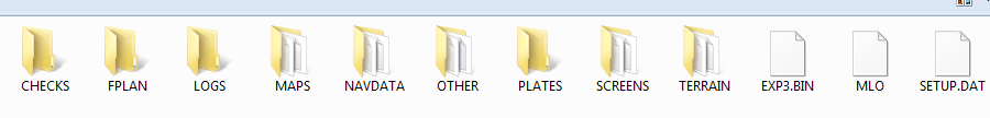

Rainier,
The message does not go out but continues to repeat and unit never powers up. I have attached the screen copy of what is contained on the
internal SD card. Seems normal but EXP3.bin and MLOO are there, even though fault says they are missing.
Maybe I didn't get the software patch it needed?
Don Wiltse
Don Wiltse
- Internal SD Card Folders and Files.png (12.23 KiB) Viewed 4112 times
- Internal SD Navidata files.png (5.63 KiB) Viewed 4112 times
