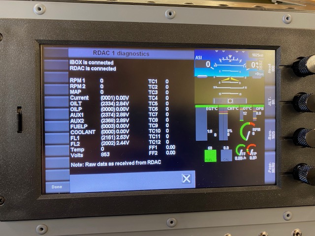

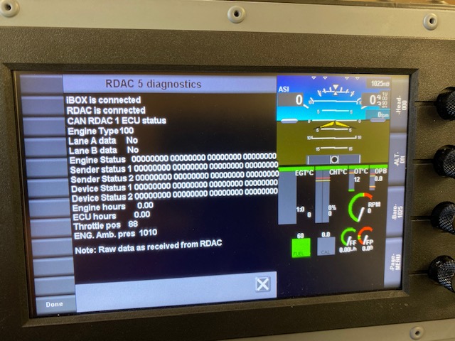

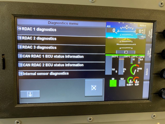

My setup is as follows: UL Power engine, single ECU, RDAC CAN for engine data, RDAC XF for termocouples and tank level. iEFIS Discovery.
From the ECU I have the RS232 TX connected to pin 3 in the DB9 connector of the RDAC CAN. Pin 6 and 7 to the CAN BUS. RDAC CAN dip switches currently 1 on, The RDAC XF is set up as RDAC 3 (A off, B On).
On my iEFIS custom engine screen, I have set data sources for ECU data to RDAC 1. EGT/CHT and FL1 data source is RDAC 3 (XF)
When running the system, I get data from RDAC 3 just fine, but few data from the ECU (RDAC 1). The only ECU data I see working on the iEFIS is the oil temp.
When running the engine with UL Read hooked up to the ECU, I get all engine data ok, so I know my engine sensors are working fine. It semes to me that the ECU data gets lost passing through the RDAC CAN, and I am currently stuck on how to fix this.
I have attached a few diagnostic screen images, any help with trouble shooting or solving my issue is highly apprechiated.

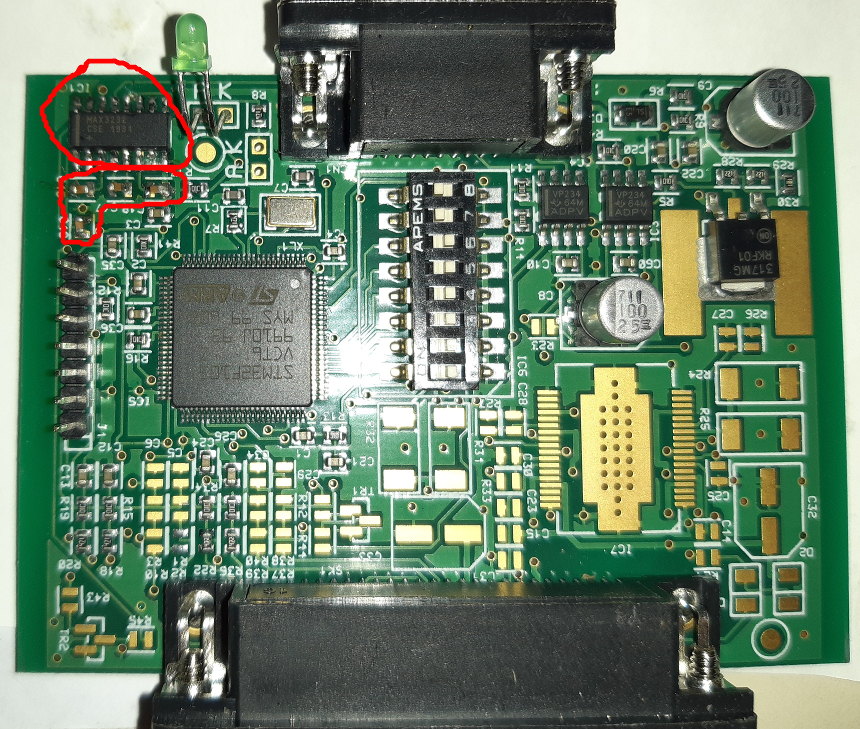

Rainier replied to me that:
The intention is to connect the ULP RDAC to the engine via CAN.
Standard RDACs do have firmware support for the RS232 but the RS232 driver chip is not fitted.
Note that we have a firmware update to support the newer ULP engines that changed the CAN baudrate.
In most cases the firmware will need to be programmed by your dealer but it is possible to do that via RS232 after the driver chip has been soldered in (this chip can be soldered by hand, it is a MAX3232 in SO16 package. Also needs 4 x 100nF ceramic capacitors in 0603 format, all 4 of them right next to the chip - can't miss it).
At Reichelt, I bought for less than 3 EURO:
MAX 3232 CSE - RS232, 2 drivers / 2 ontvangers, SO-16
KEM Y5V0603 100N -Multilayer-keramische condensator, 100nF, 25V, 85°C (4x)
Soldered them in the RDAC (SMD is horrible if your eyes are over 50) and it works!!!

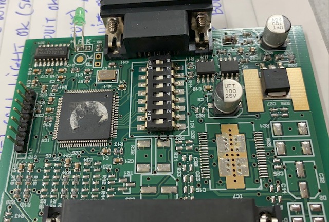

Thanks for the input everyone.
I have yet to sort out the issue with communication between the ECU and the iEFIS (via RDAC CAN).
Looking at a picture of my RDAC, it looks like I already have the correct items installed on my unit..
Also, it was mentioned in a conversation with MGL Support US, that my RDAC was a 2014 modell (purchased 2017). Being an early model, it may not be configured correctly.
Regards Rune
Regards Rune
