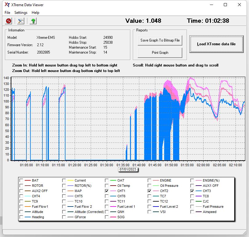

Tried to use the Xtreme Data Viewer XTDV v2.0 and can't get it to work.
Throws an "invalid floating point operation" during the file load, then says its loaded, then shows nothing but one red line (the same one as when it first starts.
I load a second time and don't get the error, but it still shows nothing.
I attempt to resize the window, and again get the invalid floating point exception.
I have attached one of the files that causes the exception

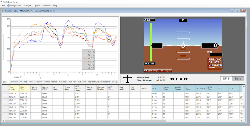

Ah, didn't see your attached file at first. Here it is in a screenshot of the FlightDataViewer...
- Kbong_EMS_data.png (213.69 KiB) Viewed 10071 times

Hi Kabong,
Make sure you are using Version 2.00 of the data viewer. Also uncheck all parameter boxes before loading the file. I checked on my side and all working correctly.

Re: Xtreme EMS Data View Fails
Turning off all checkboxes worked for the loading.
By the way.
QNH is the checkbox causing the floating point error.
Once selected, the error occurs, then ALL checkboxes fail to work, and the selected value cannot be changed.
You have to exit and reload the app to make it work.
