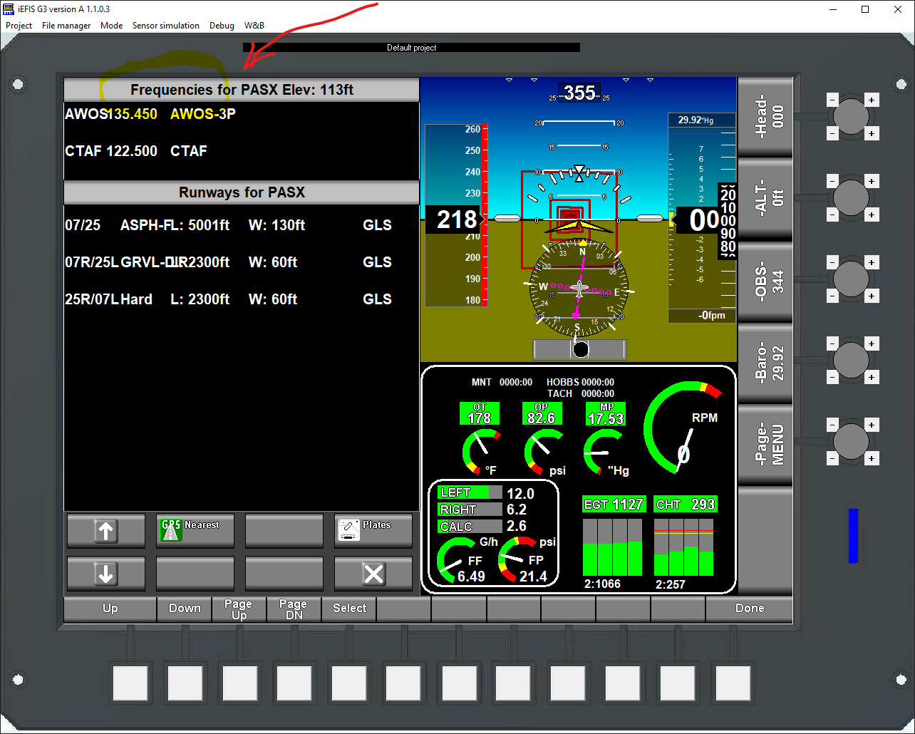

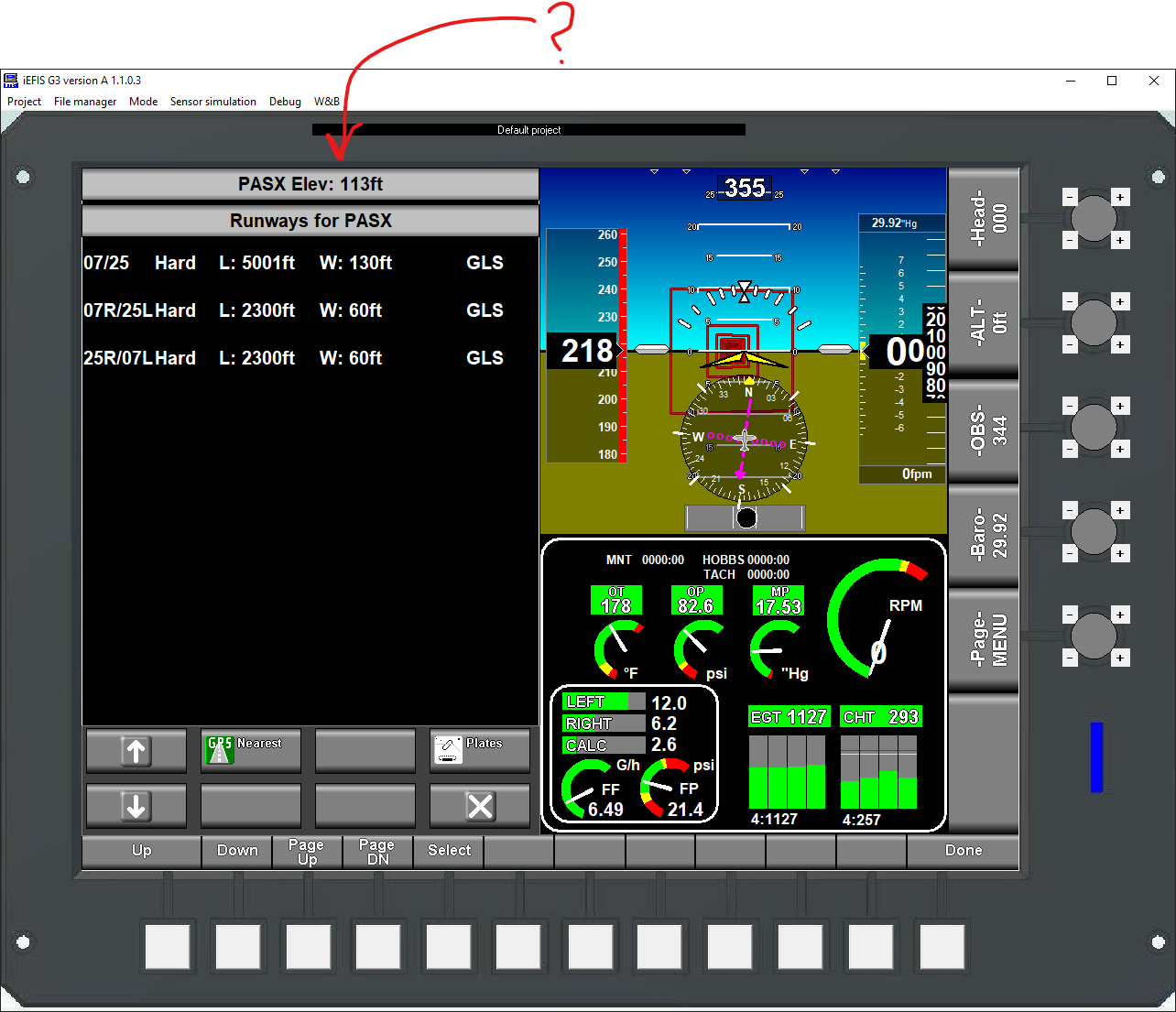

OK, I'll ask this again with pictures: where are the radio frequencies in the latest US database update?
Screenshot 2020-10-27 155647.png (157.84 KiB) Viewed 11463 times
Screenshot 2020-10-27 155629.png (161.68 KiB) Viewed 11463 times
Am I asking the right question to the right place?

The freqs were missing on my last update as well. I just went back to the previous version and all is well.
iEFIS Discovery Lite
in a Xenos motor glider
Re: Database update missing frequencies?
The frequencies are picked up from the FAA ARINC 424 database.
If they have been removed for that airfield by the FAA then they will not show on the EFIS.

I tried the most recent navidata.ewd file and found no airport frequencies either. It sure is handy to be able to transfer frequencies from from airport info to the radio with a single push of a button.

I am missing the frequencies as well. I believe I remember reading that they were no longer merging the data from www,navaid.com because the data was no longer being updated and some of the data was inaccurate.
Here is the excerpt from page 10 of the mgl central database tool instructions:
As of writing this document, the FAA ARINC data does not include “Communication records”,
effectively records that contain airport frequencies and descriptions.
Because of this, we now do a further step:
Step 3:
Go to www.Navaid.com and download data in GPX format that approximately covers North
America. To keep the download smaller, choose only airport information. This information
includes frequencies.
Terry

Here are the instructions if you are in the US and want to build your own Navidata.ewd that contains the radio frequencies:
1. Install Mgl Central
2. Follow instructions on page 10 of MGL Central.pdf
Download the latest files from the FAA
1. Faa cifp data
https://www.faa.gov/air_traffic/flight_ ... /download/
2. Faa DOF
https://www.faa.gov/air_traffic/flight_ ... ducts/dof/
Merge airport information (frequencies) Step 3 on page 10 of instructions
www.navaid.com
WARNING: Use at you own risk!! Test in the simulator first. The data on www.navaid.com was last updated a year ago!!
