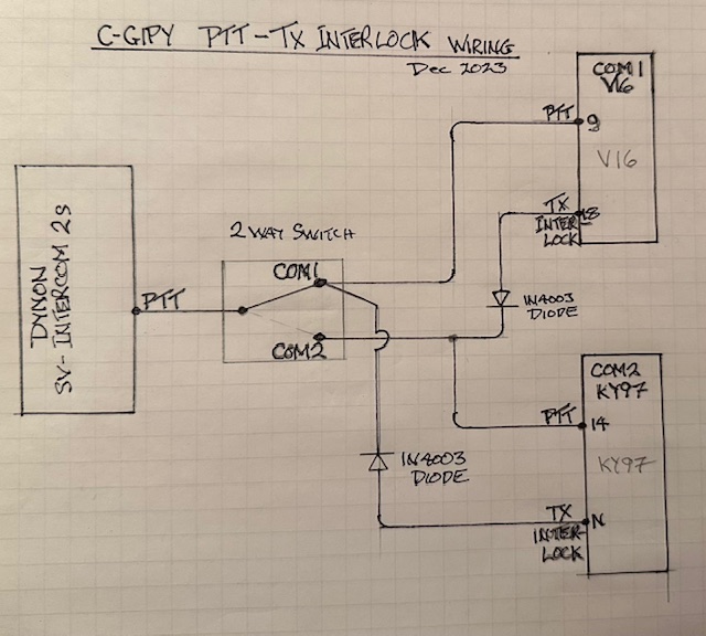

I started this thread back in 2021. I have a Dynon SV-Intercom 2S connected to a V16 com and a KY97 com. Back then I tried connecting the TX Interlock of the V16 to the PTT of the KY97a and the PTT of the V16 to the XMIT Interlock of the KY97a. This didn't work. The V16 interlock caused the KY97 to near continuously transmit. So back then I removed the V16 TX Interlock wire and then I could transmit on the V16 and receive on both radios. If I wanted to transmit on the KY97 I would have to bring the V16 volume to zero or power it off. Then recently I tried putting the V16 Interlock wire back with a 1N4003 diode in the line. I also put a diode in the K9Y97 TX Interlock line. Now I can select via a switch which radio I transmit on and it works well with the audio on the non-transmitting radio being muted.
GIPY PTT - Tx Interconnect.jpg (108.12 KiB) Viewed 11924 times
At the moment receive on both radios is very good and transmit strength on both radios is good (5). Transmit clarity on the KY97 is good (4). Transmit clarity on the V16 is fair to good (3 to 4) with slight feedback and noise. I am going to try to put audio isolation transformers (Bourns SM-LP-5001) on the V16 microphone in and audio out lines to see if I can improve the clarity of the V16. Does that make sense?

Further to the above, I installed a Bourns SM-LP-5001 on the V16 microphone-in line and now both the V16 and K97 work well :)
