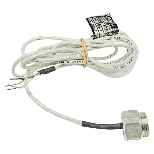

I have struck a couple of installs with this problem- some you can fix by tweaking the sensitivity, but I have found the quickest, simplest, most reiable solution is to fit a UMA rotation sensor to the mag body. Aircraft Spruce sell them (10-02432, 10-02433). Rock solid across the rev range.

Neat, but I don't think that can help me. That unit is 4.5" long, and I don't have that much available between the firewall and the magneto.

Don't believe that 4.5" long dimension.
The sensor fits in an inspection hole in the side of the magneto body, and will stick out about 1" max including the wiring bend.
