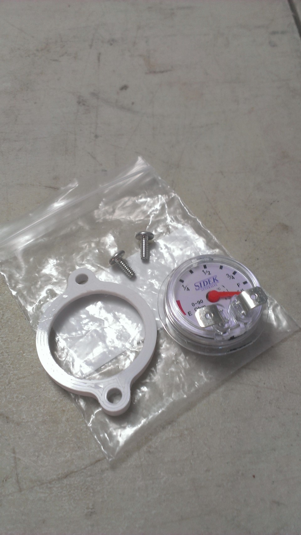

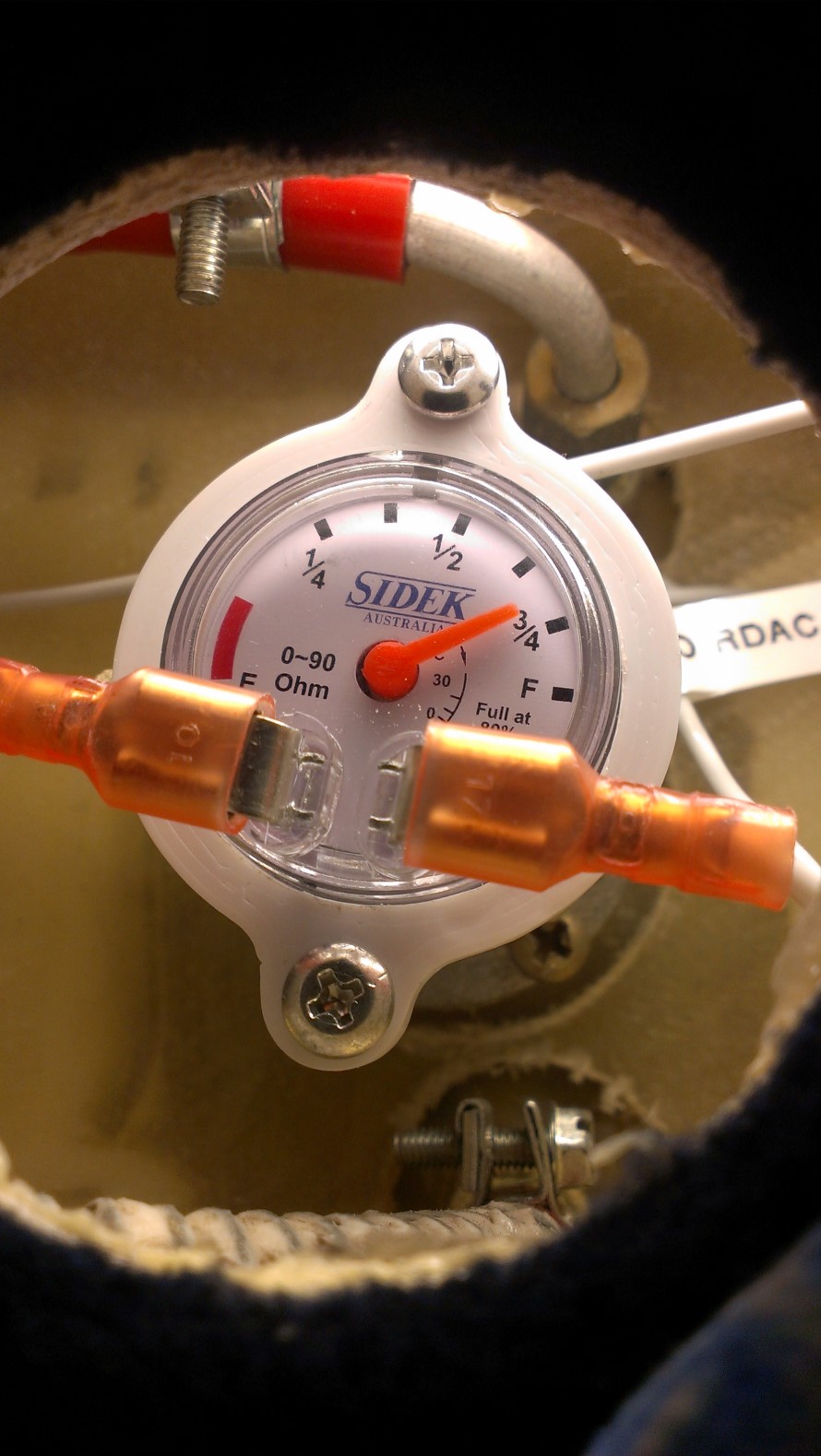

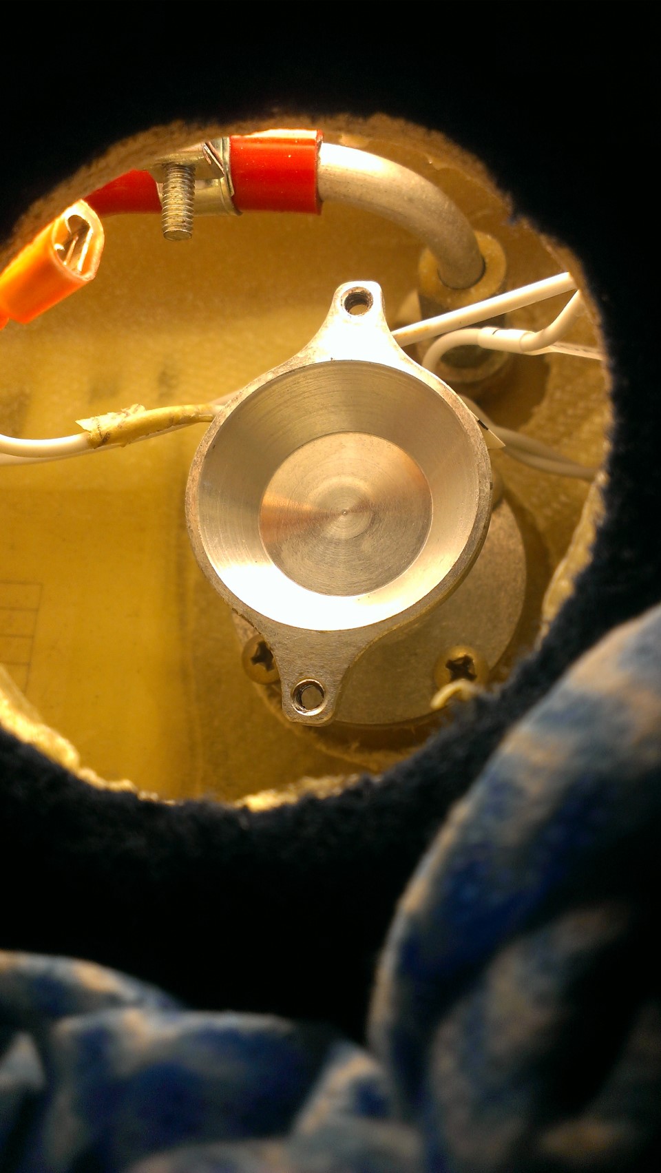

Here is something of interest for all the Jabbers amongst us, when I did my first Jabiru fuel tank/gauge calibration and trying to sort out why my MGL fuel gauges always reading full (I found the wing tank gauges were not earthed to the engine/RADC earth point, but to the instrument panel earth bus, this prove to be causing many of my EFIS engine gauges to be very flakey and misread).
So after fixing this earth issue, I found one of my wing tank gauge/sender units was reading 1/4 full when the tank was actually empty, when the gauge was reading 3/4 full the tank was actually 1/2 full, not a good thing to have happening.
The Jabiru wing tank gauge/sender units are connected to the float on the inside of the fuel tank via magnetic coupling. In my case the magnetic coupling needed to be re-calibrated and to do this required the wing to be removed as I was told.
So I needed another solution and the following allowed me to fix the gauge/sender unit magnetic coupling calibration and allowed me to actually match the fuel level and sender unit reading for use with my MGL EFIS, by having a slip collar around the gauge/sender and being able to adjust the sender unit ohms.
Fuel Gauge Base Plate.jpg (221.05 KiB) Viewed 37656 times
Fuel Gauge Slip Collar.jpg (241.21 KiB) Viewed 37656 times
Fuel Gauge Slip Ring.jpg (202.11 KiB) Viewed 37656 times

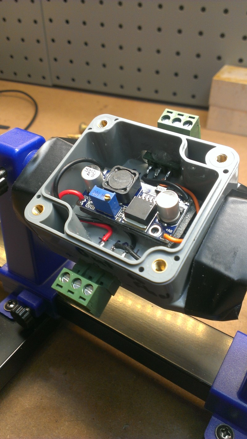

I have finally got around to making up Steevo's idea of a 10v DC regulated power supply for my Fuel Flow Sensor in my Jabiru.
The module I am using is a Jaycar XC-4514 DC-DC Step-Down Module.
I am yet to install this in my Jab 430 and will report when I do so.
But I am really thankful to Steevo who found this solution that worked for his Fuel Flow Sensor in his Jabiru and then sharing it with us and I am hoping it works for me as well.
In my prototype power supply, I have run the Fuel Sensor signal wire through the box, as I am hoping this will not pick-up to much electrical noise as I want to be able to easily jump the Pull-Up-resistor from the signal wire terminal to the positive wire terminal inside this box.
Steevo or anyone else, if you can see any problems with my prototype set-up, please don't hesitate to comment and share your thoughts.
I am pretty excited to see if this 10v DC power regulator unit will make my Fuel Flow Sensor read accurately through out my entire RPM range.

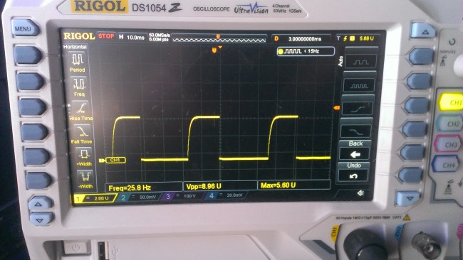

But so I have a base line of what the current flow signal is currently, I put a scope on the signal wire at the RDAC.
I think I have a pretty good 5V DC wave signal coming from the Flow Sensor at the RDAC with the fuel flower sensor back behind the sound wall near the header tank and electric fuel pump. I was thinking there may have been a voltage drop over that distance, but it seems ok.
But what I have noticed is that the pulse frequency is fluctuating pretty bad, like from 18Hz to 25Hz or 4Hz to 7Hz for their given engine RPM setting.

Signal Base 5v from  RDAC
