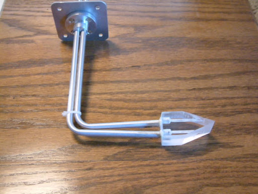

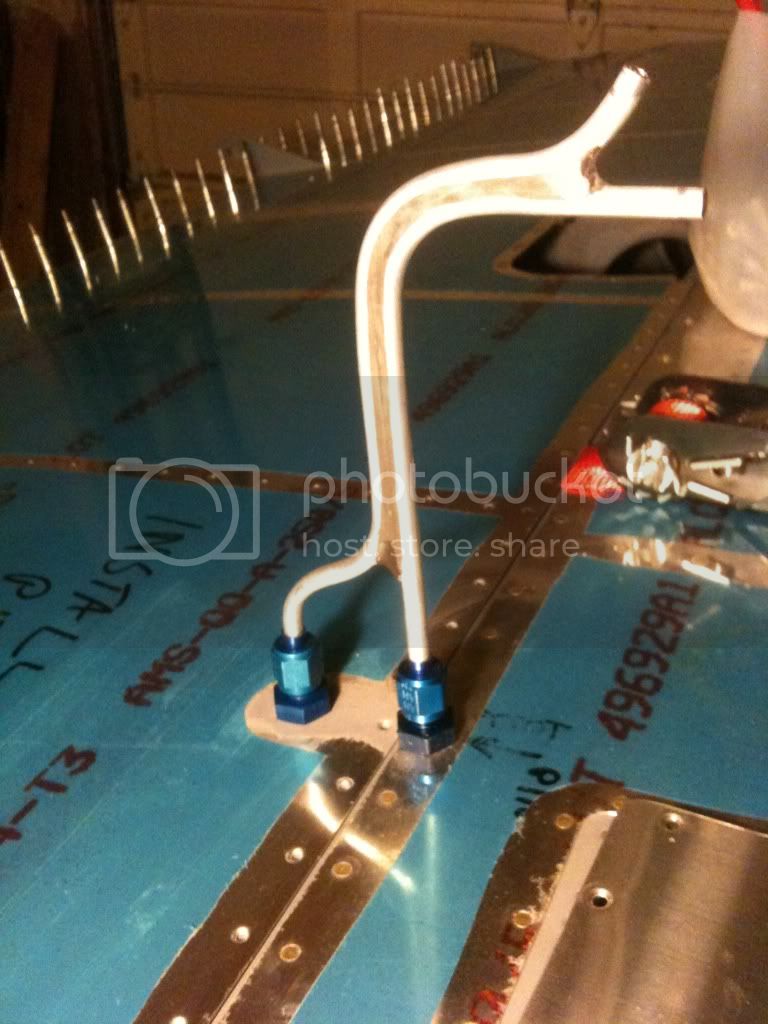

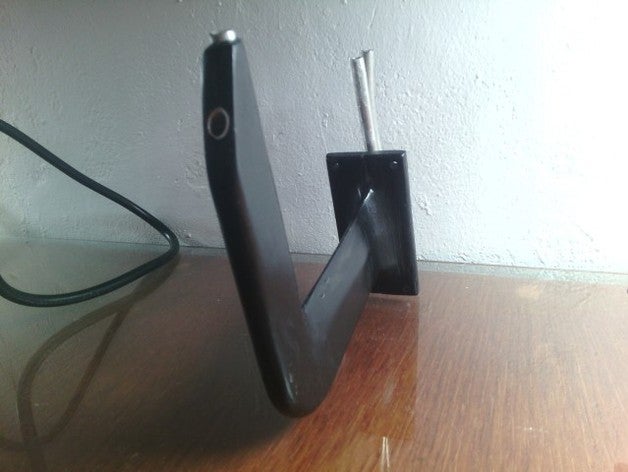

Re: AoA differential port locations
Yep, plenty of similar ideas out there; from 3D printers to bent aluminium tubes
