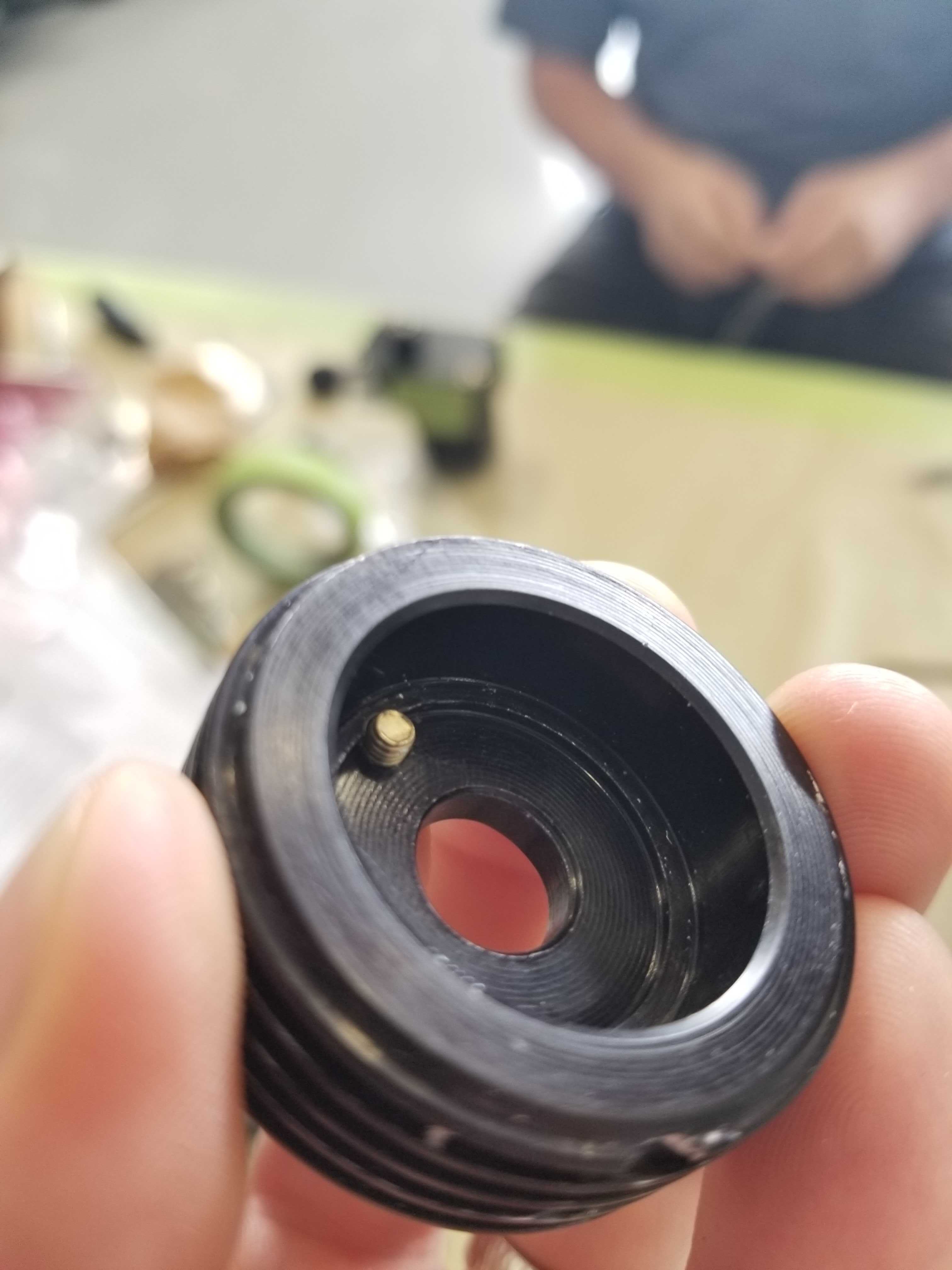

Thanks Rainier. I've got a followup question. The capstan is thicker than the arm it replaces, but doesn't come with a new shear screw. As a result, insufficient threads are exposed. At best, I'm getting 1 thread engaged, which is obviously nowhere near enough for a secure attachment. Is there a longer shear screw I should be using? I'm hesitant to improvise here since this is a critical component of the fail safe system.
In the attached photo it LOOKS like there are 3-4 threads, but thanks to the lip on the side, only 0-1 can actually engage with the collar.
Re: MGL Capstan Kit Range of Motion
You can fit a longer screw or even countersink the hole a bit deeper.
We like using brass screws here as they have just the perfect properties for this application but you can use a stainless screw as well.
It is M3 thread.
