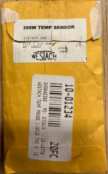

I have the Westach Carb Temp sender as supplied by the local MGL distributor, connected between Aux 1 and RDAC ground.
It is selected to Carb Temp on the screen for my own new indicator graphic , however it shows 0 (Zero degrees) for any value below 20 Degrees ( and works the same for the Simulator as well).
I am trying to get the indication to give the actual probe temp value down to Zero degrees, and start flashing when it gets to 5 Degrees.
Do you have any thoughts or solutions on what I am doing wrong or how to get it to work correctly please.
Richard.

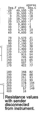

The resistance for the 399W westach carb sensor is here.
What is the best settings to use to get down to 0C. Thanks.
