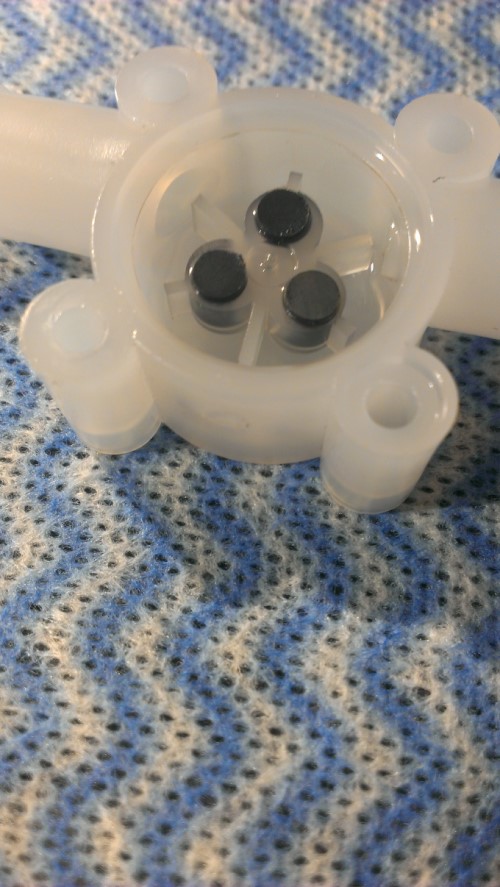

Well, here is an update on my Fuel Flow Sensor's really bad pulse frequency fluctuations.

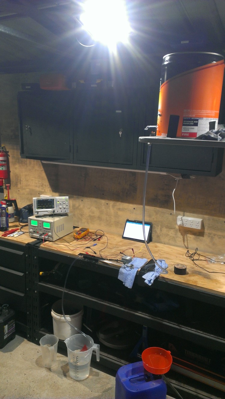

I decided to remove my Fuel Flow sensor and bench test it. The results on the bench test where the same as in the plane with the pulse count fluctuating all over the place for any given gravity feed rates between 2Lph to 35Lph.
So I cleaned out the impeller and found nothing that might have block the impeller. I check the 2mm jet was seated all the way in and put the sensor back together. Using a length of 8mm tube, I then blow a very light amount of air through the sensor and watched the impeller turn under a bench magnifying glass. At these very slow rotation rates and at faster rotation speeds, I could not see the slightest hesitation or binding in the rotation of the impeller at slower rotation speeds or as it slowed down from spinning faster.
I was hoping the problem may have been fixed, so I put the sensor back on the bench test rig. Sadly the oscilloscope continued to showed a wide range of pulse fluctuations, I mathematically calculated this could cause up to +-15% variation in fuel flow rate.
So I ordered a new fuel flow sensor from Stuart the MGL Dealer in New Zealand, I have found nothing but great service to me here Australia.
So as soon as the Flow sensor arrived, I bench test this new unit to find the pulse frequency was very stable with in 0 to 0.5Hz for the lower fuel rates and from 0.5Hz up to 1Hz for the higher fuel rates of 35lph. I also used Stevo's box, as I called it with the 12v DC input supply to 10v regulated DC output.

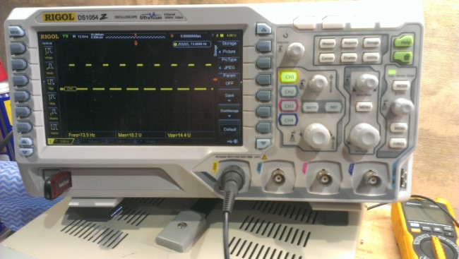

I certainly like the look of the oscilloscope fuel flow pulse as in the pic with both the regulated 10v DC supply and the new flow sensor.
So what's wrong with old fuel flow sensor, my guess it has a problem with the internal electronics that is causing those wild pulse fluctuations.

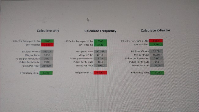

I also used a spread sheet to keep a check on what the K-factor would calculate out to be for any given Lph and pulse frequency. The bench testing of this new Flow Sensor and my spread sheet calculations showed the k-factor very close to 7000 as in specs for the 2mm jet. I my case the K-Factor worked out to be 6665.

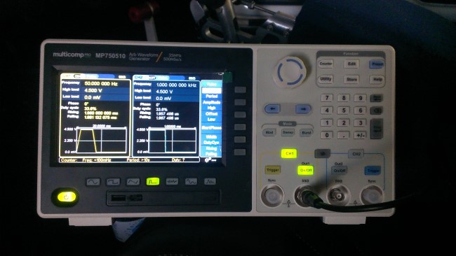

So to Test 1.
I connected my signal generator to the signal wire. I set my signal generator to emulate the pulses from a fuel flow sensor with the pulse voltage set to 4.5v, the RDAC supplies 5v, so I thought after a little voltage drop getting to the back of my aircraft, 4.5v would be in the ball park. The EFIS's and spreadsheet K-Factor was set to 6665 which is the K-factory worked out from my bench testing.
I emulated 25 different Flow Rates/Pulse Frequencies with only the EFIS and signal generator turned on. I checked the EFIS's LPH readings against the mathematical calculations for that Pulse Frequencies. Through out the range from 0.54 to 54 LPH all the EFIS's readings were within 1% of the calculated flow rate. So the Voyager EFIS and aircraft wiring harness both passed this emulation testing with flying colours.

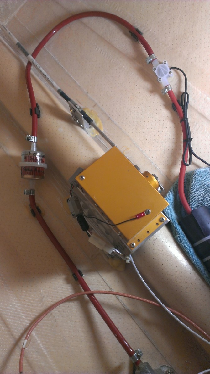

If you have been reading this thread, you will know I had check every aspect of the Fuel flow Sensor, EFIS and sensor wiring and the last of these tests is to sort out the issue of the electric fuel pump when turned on, it changes the EFIS's LPH reading to go higher or lower and remain there until the pump is turned off.
This pic below shows the way my Jabiru 430 fuel flow Sensor was originally set up.
The electric fuel pump is just out of the pic on the left lower corner and on the bottom right corner is the black rubber cover of the fuel filter.
It showed from all my testing when turned on the electric fuel pump's short distance from the fuel flow sensor, could caused cavitation's and send fuel pulses back up into the Flow Sensor, this could changed the sensor's pulse rate and in turn changed the EFIS's LPH reading whilst the pump was turned on and this would make the flow rate very flakey and erroneous when the pump was on for anytime.
Fuel Flow SensorR3.jpg (189.87 KiB) Viewed 25285 times

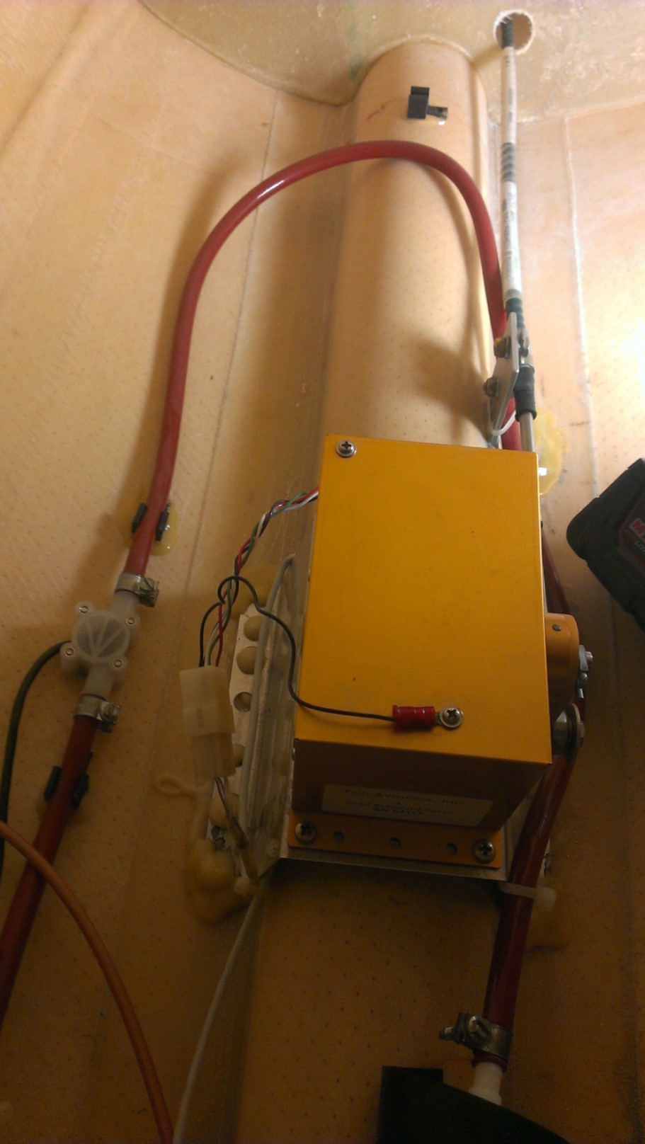

So I change the positioning of the Fuel Flow Sensor as far up stream from the electric fuel pump as I could, and added another fuel filter as Tasmag suggested to help dampen the fuel pulses and cavitation's from the electric fuel pump.
In the pic below, on the bottom you can see a hose clamp on the electric fuel pump and on the right side you can see again the black rubber on fuel filter and down stream is the Fuel Flow sensor and then the extra fuel filter I am using to dampen the fuel pulses from the electric fuel pump.
So what is the outcome of all this, well due to the weather on the day I made these changes, I could not take the plane for a fly after we did some exhaustive ground running at different RPMs with the wheels chocked and the electric fuel pump on and off at each RPM setting. This extensive testing was as much about making sure the new fuel hose routing was not going to cause any fuel flow issues.
As to the EFIS reading of the LPH, I am pretty excited to see at any RPM, when the electric fuel pump was turned on, the EFIS's LPH would rise for a couple of seconds and then settle back to the same LPH before the pump was turned on. When the pump was turned off the EFIS's LPH would rise for a second and then settle back to the same LPH reading.
I am very happy with all this at this stage. I have not installed Stevo's 10v regulated power supply as yet, but I think I will do some flight testing first with the 5v from RDAC, before I install the 10v regulated power supply.
New Flow Sensor SetupV2.jpg (156.73 KiB) Viewed 25285 times

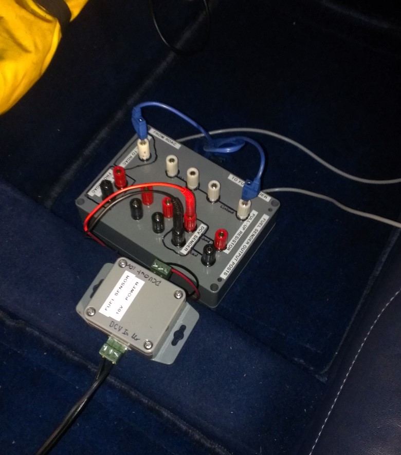

I made this simple test rig, so I can insert it into the Fuel Flow Sensor wiring via the cable plug near the Flow Sensor. I have not done any inflight testing with it yet, my work has got in the way once again.
It took a little bit to make, but I wanted an easily reliable way in flight to switch between the two different power sources, the RDAC 5VDC supply and the regulated 10VDC, which is being supplied from my aircraft's 12VDC system. We can also easily change the pull-up resistor to try different values.
I did not want to deal with the possibility of having bridging clips, unclipping, shorting or causing any type of intermittent connections or false reading inflight from vibration or a bad connection.
So now, I am in the process of borrowing a battery operated signal generator and oscilloscope. So we can test inflight the different pulses signals and see the difference between the LPH reading from the Fuel Flow Senor using the different voltages. I will connected the oscilloscope to the RDAC signal input to see how the different pulse signals look inflight as well.
With many aircraft types you just can't go and do this type of thing, so you should check first. But having an Experimental Register aircraft does allow you to experiment with it, with properly skill people.
P.S. the labels on the test rig may not be right, eg. "Sender" instead of "Sensor" :shock:
