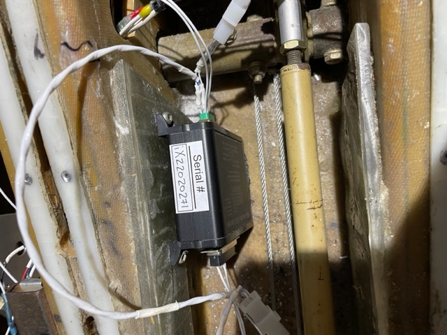

I suppose the first port of call would be to see if anything else that is plugged into the iBox is showing up on the iEFIS. If it's not then I would suspect the connecting cable between the two.
If the iBox info is transferring to the iEFIS then you can zoom in on the obvious. Have you got power to the Extender (easy to check to see if the green light is doing anything). If you've got power then it boils down to the CAN bus. Check for continuity from the DSub pins and that they are wired the correct way round and ensure you've got the terminating resistor in place.
I don't know if the Extender can be enabled without it being connected (I would suspect not) but, if it can, remember you need to turn the power off and then on again to save the setting.
If power is definitely okay and the CAN bus is okay then you may well just have a duff Extender.

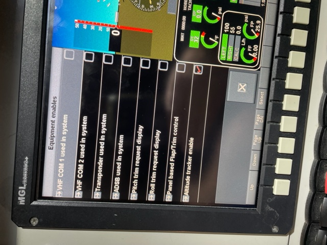

thank you for your answer the can bus is ok the green led of the extender flashes correctly on the screen in the menu equipment enables it does not appear extender module but altitude tracker ???
attached two photos

What's the software version on your iEFIS?
I don't think I've seen that option on mine. So one of us is out-of-date (but I'm not changing mine, as the latest update seems to be cocking everyone's systems up).
