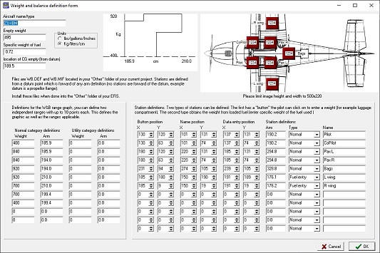

There's actually no menu setting for these numbers. They can only be pre-defined in the "wb.def" file and any changes would require the creation of a new wb.def file in the simulator and uploading that to the EFIS.
When you create that file using the weight & balance function in the EFIS simulator/designer, there is a box near the top left to enter your empty weight. That's the only place you can define it. The MTOW is treated slightly differently because it's a limitation, and must be entered as a "definition" in the table at bottom left so that it appears as a limiting point on your graph.

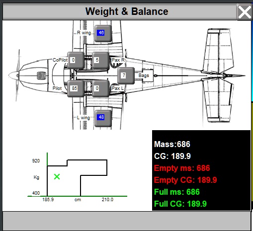

I get all of that - what I can't understand is that in my simulator, When I bring up the weight and balance I only see one cross on the graph - the green 'full ms/fullCG' one, whereas on your video you definitely had a white, red and green cross - i.e I need to see the C/G range for a given load..
have attached a image to show what my setup is - I'm sure I'm doing it wrong somehow...

Ah ok this seems to depend on whether your fuel tank selection is a virtual tank (you just get a display of the current CofG) or a "sensed" fuel tank, where you get the other crosses.
My Pitts actually has only a virtual tank - fuel remaining is calculated by fuel flow in the EFIS and I just have the single "x" depending on what fuel value I manually enter. The example I did, which was an RV, had actual sensed fuel selections in the setup.
Interestingly I just altered the tank selection from virtual to sensed in the w&b setup in the G3 sim (after which it displayed the red and green "x"), then tried to alter it back to what I had, and it keeps locking up! There's some odd buggy behaviour there.

Re: Weight and Balance G3
That's what the thing does.
You define a station as fuel. It then calculates the position of your cross based on fuel load. Similar for baggage etc.
It needs physical fuel tanks for that. Virtual tanks are not counted.
