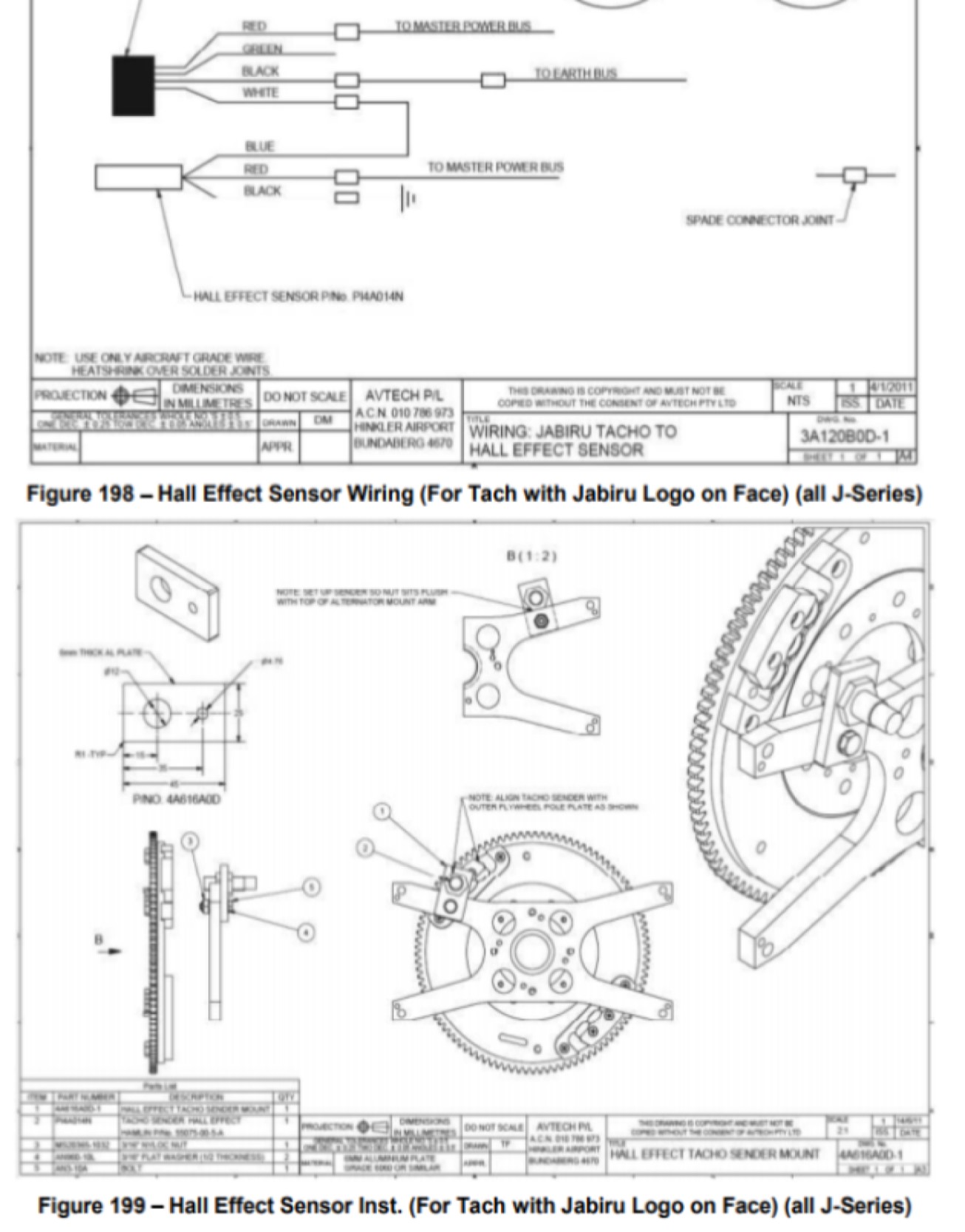

I have found in the Jabiru Aircraft Technical Manual JTM001-9, page 264, Figure 198 &199 this refers to the fitting of a plate and an Hall effect sensor.
The Hall Effect sensor used by Jabiru here, is a Hamlin P/No. 55075-00-5-A, that has a M12 Barrel and adjustable thread length of 36mm, there seems to be other Brands that are similar style and electronically spec's.
Sorry about the poor quality of the print and picture, but for the interest of other Jabiru owners, I have attached the Jabiru Aircraft Technical page.
In my situation, I will have to machine a hole for the Sensor plate in the Alternator Spider bracket.
JTM p. 264 may no longer be Correct. Please check first.
Jab Flywheel Hall Effect .jpg (235.48 KiB) Viewed 11675 times

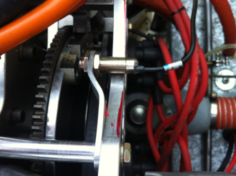

Here is a pic from the Jabiru Owners Group forum, the owner here has mounted his sensor slightly differently to the way Jabiru has done it and shown in the Jabiru Technical Manual above.
Retro Hall Effect SensorR1.png (144.6 KiB) Viewed 11671 times

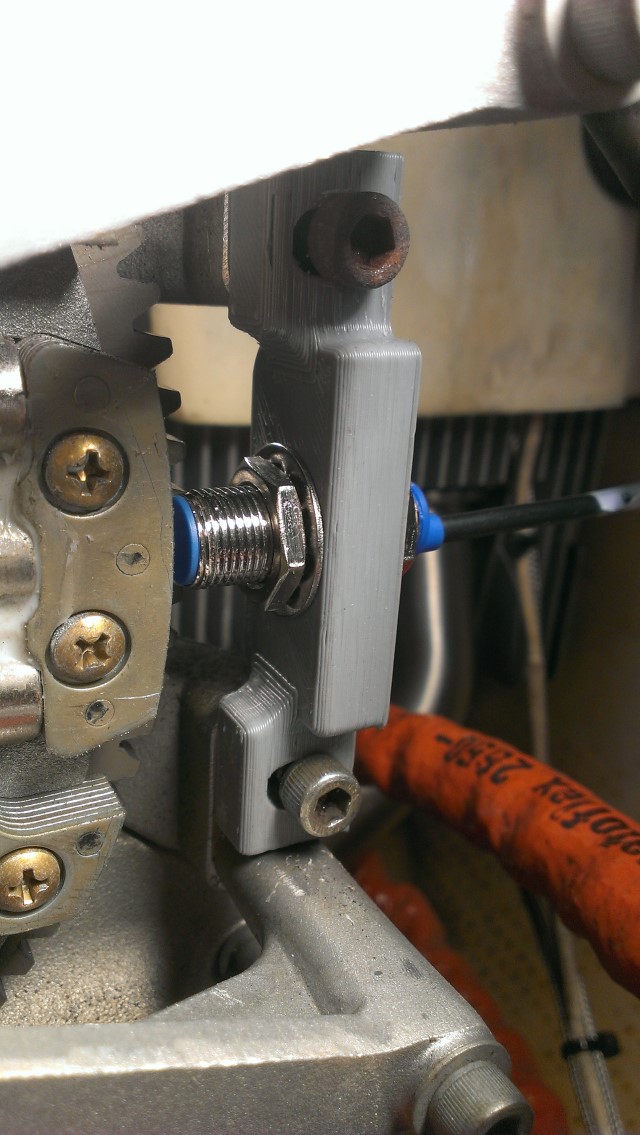

Just to follow up on this post with a few pic's and words.

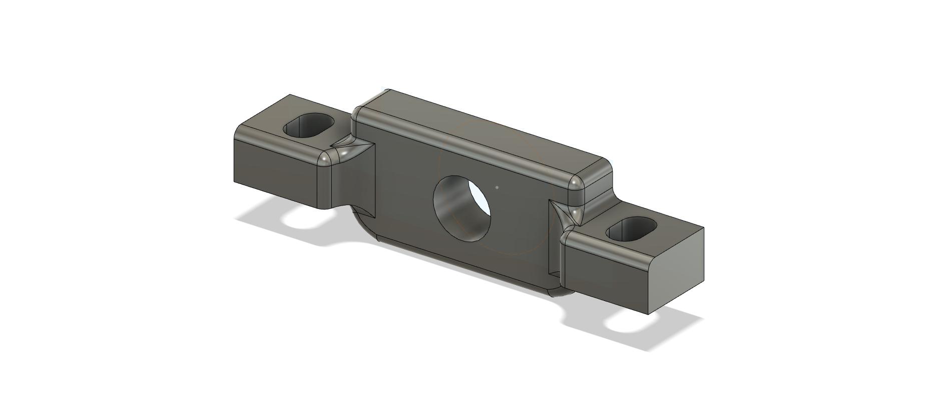

I decided firstly to draw up a 3D drawing in Fusion 360 to suit the NJK-5002c Hall effect sensor, so I could test the sensor by having it mounted on the spare ignition coil mount on the Jab Gen 4 3300 engine. Well this Hall Effect sensor past with flying colors, the RPM was stable through out the RPM range. So the next step, I will mill up an alloy bracket.
Fusion 360 Jabiru Bracket
Jabiru Gen4 NJK-5002c Bracket B..jpg (50.73 KiB) Viewed 11478 times
Here is a pic of the 3D plastic bracket and sensors on the Jab Gen 4 engine. This Hall Effect sensor only switches when a magnetic south pole goes past. As the center part of the flywheel ignition magnet is magnetic north, the outside two poles are magnetic south, so you will get 6 magnetic south pulses per revolution for a 3300, your EFIS RPM setting will be set to 6 pulse per revolution. Warning, don't try to use this 3D plastic bracket in flight, you will find when testing the sensor on the ground the bracket will deform from heat and mounting bolts will lose their torque after a bit.
Bracket and Sensor Mounted
3D Print of the Hall bracket for Jab Gen 4.jpg (139.03 KiB) Viewed 11478 times

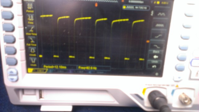

Now if you remember the scope picture at the beginning of this post, I had a very strange pulse pattern from the ignition coil wire as the RPM sensor, yes it worked, but in my case very poorly. Here is a blurred scope picture, but it shows this Hall Effect pules with a nice regular pulse pattern.
Sorry its not a good picture
Scope of the NJK-5002c Sensor.jpg (36.41 KiB) Viewed 11478 times

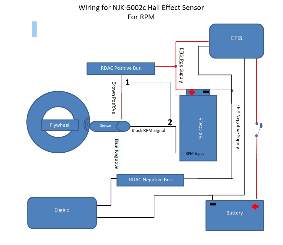

One last thing you may ask, how did I wire up the NJK-5002c Hall Effect Sensor.
Here is a bit of a drawing, I have not added a pull-up resistor, (between 1 and 2) this might be wrong, but I think this brand of Hall Effect sensor has one built into it?, as it does not seem to have any floating state on the signal lead.
But if anyone feels there is something wrong with the drawing or anything else, like not having an in line resistor on the signal wirer please don't hesitate to say so, I have put this drawing up here for future reference for all Jab owners and I want it to be right for me and everyone else.
The final result, its been time consuming going through the process and having to check stuff along the way, this has caused me a bit of uncertainty but the result was worth the effort. I am really happy as my engine now purrs along nicely with a stable rpm.
One last thing, you can make the bracket many other ways, but if you would like to have the CAD drawing, just ask.
Cheers JimJab
Wiring drawing of Hall Effect Sensor.
Hall Sensor bracket for Jab Gen 4.jpg (74.63 KiB) Viewed 11478 times

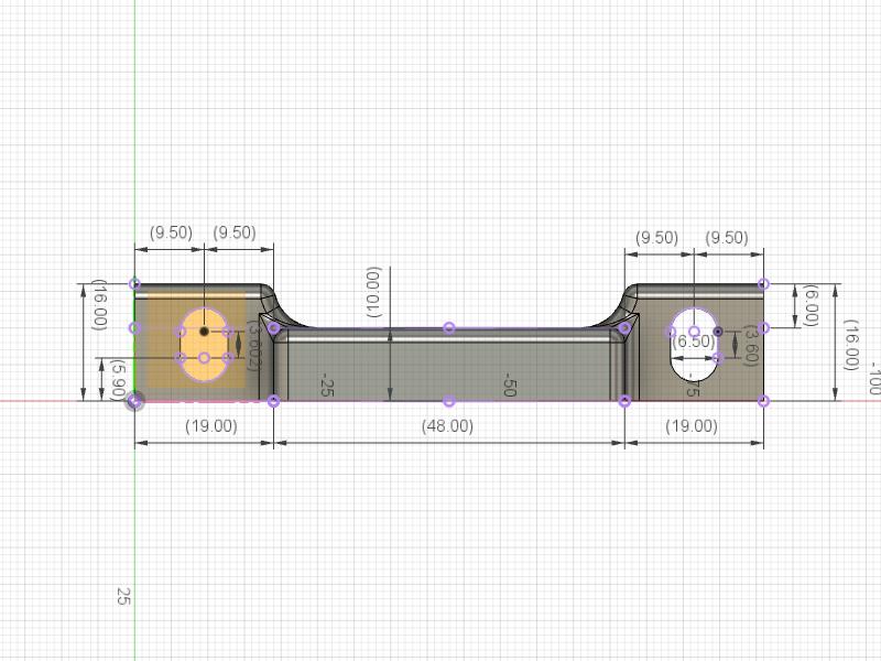

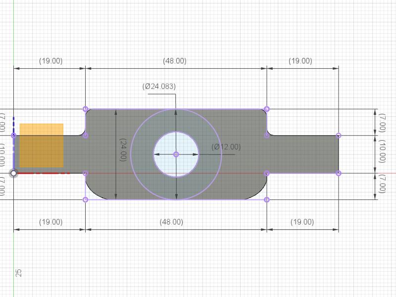

Here are some Fusion 360 drawing with the dimensions of the Hall Effect Bracket for the Jabiru Gen 4 Engine.
Whilst I was able to mill this bracket, many may not have the gear or want the cost of getting someone else to mill it. I reckon you could use 10mm x 25mm aluminum straight bar to make this bracket, with some straight cutting of the mounting tab's using a hacksaw.
When drilling the mounting holes 6.5mm or for some wiggle room 7 mm holes, drill them as close to the fly wheel side of your bracket as possible. This will give you as much clearance as possible between the bracket and the flywheel/magnets when mounting the sensor.
The Hall Effect sensor was about $11.00, the aluminum bar stock was about $ 3.00 AU and the rest was in time. Well worth the effort for the small amount of money to get away from the ignition coil pickup and to have a stable EFIS RPM
Jab 3300 Hall Effect Bracket Top Dim
Hall Bracket Top 800 x 600 Dim.jpg (76.1 KiB) Viewed 11414 times
Jab 3300 Hall Effect Bracket Front Dim
Hall Bracket Front 800x 600 Dim.jpg (73.74 KiB) Viewed 11414 times
