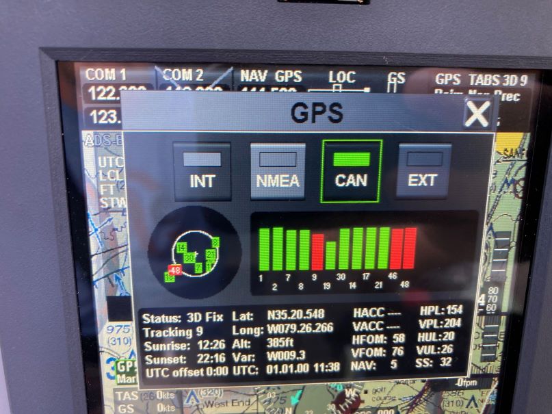

I thought it sounded like a GPS problem too, but the MX1 is tracking me properly on the chart and my location and groundspeed line up with what Foreflight is saying. I want to say that it's saying RAIM NON-PRECISION, but I can't remember. I'll be out at the airport in the morning and will take a picture of what it's saying.

I don't think it has ever said anything but Raim Non-Prec. What would cause that? I do have an SP-12 GPS on the CAN bus, and I have CAN set as the main GPS source because this is what my GPS antenna is plugged into and part of my ADSB out. There is no GPS antenna plugged into the port on the back of the MX1.

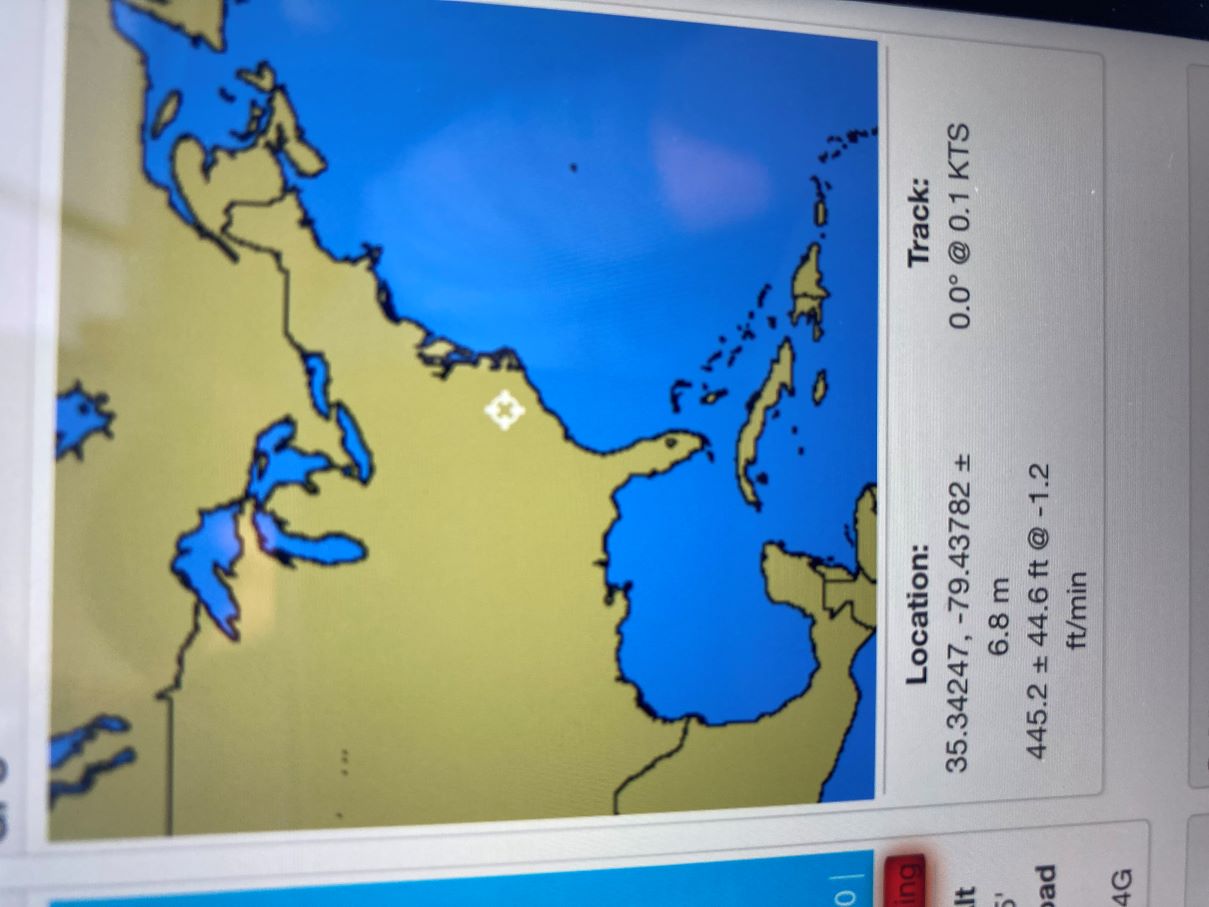

Here's a couple pictures from this morning, one from the MX1 and one from the Stratux. The Stratux location is correct, so the MX1 is about 12nm off in lat/long as well as being low by about 60 feet. The accuracy never got any better in flight. The airplane is a Rans S-20 and the GPS puck is mounted centrally on the dash with a clear view of the sky. If I touch an airport on the screen, it says "No airport at touch" or something similar. It works for airspaces though.

I am just guessing here, but, The MX1 may try to use its internal GPS for the airport functions.
I would connect the GPS antenna to the MX1 and see if that cures the problem.
Also, have a look at your settings in ...
MENU > System Setup Menu > Setup GPS and NMEA Port Ops

As far as the GPS issue goes, I'm just an idiot. I was mixing formats.
