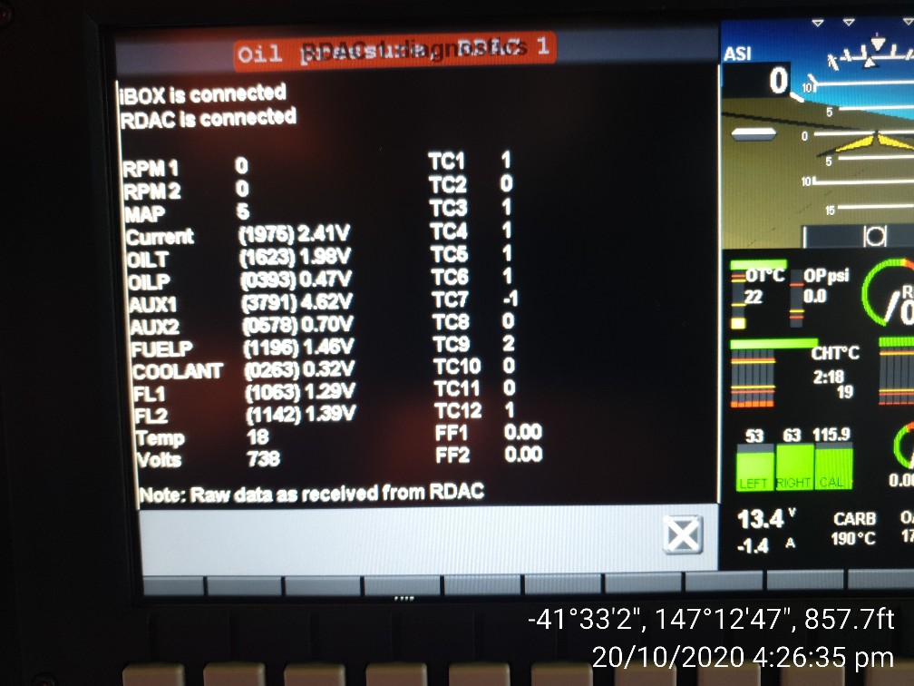

Then you go into the RDAC diagnostics on your EFIS - it shows you what it is measuring - repeat the test and look at what the RDAC is sending to the EFIS (it shows you the voltage it is measuring). If that is correct there is no hardware issue.

Checked the voltage today, showing 0v with Pull-up off, and 4.78v with pull-up on.
This was replicated with Aux1 after disconnecting the sensor.
I have also attached a shot of the diagnostics page.

A quick update.
Bit the bullet and replaced the RDAC, fixed the issue so looks like it was a hardware issue.
