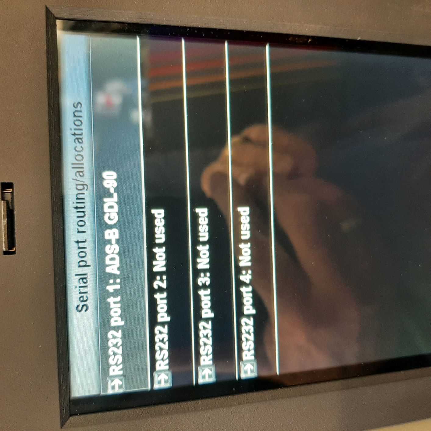

On the serial port routing/allocation menu, I have serial port 1 setup for ADS-B GDL-90.

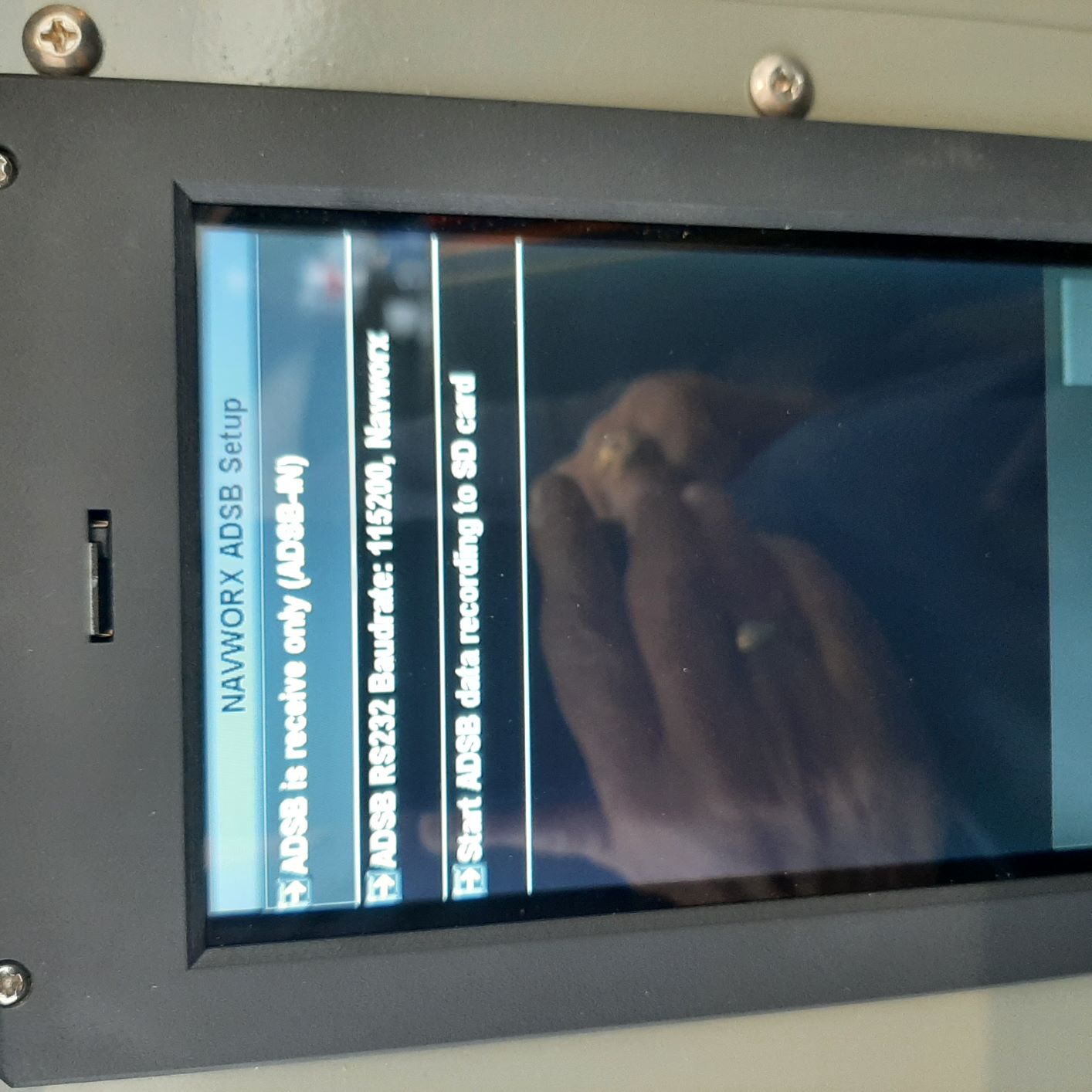

In the ADS-B setup menu, I have it setup for ADSB receive only (ADSB-in), ADSB RS232 Baudrate: 115200, Navworx.

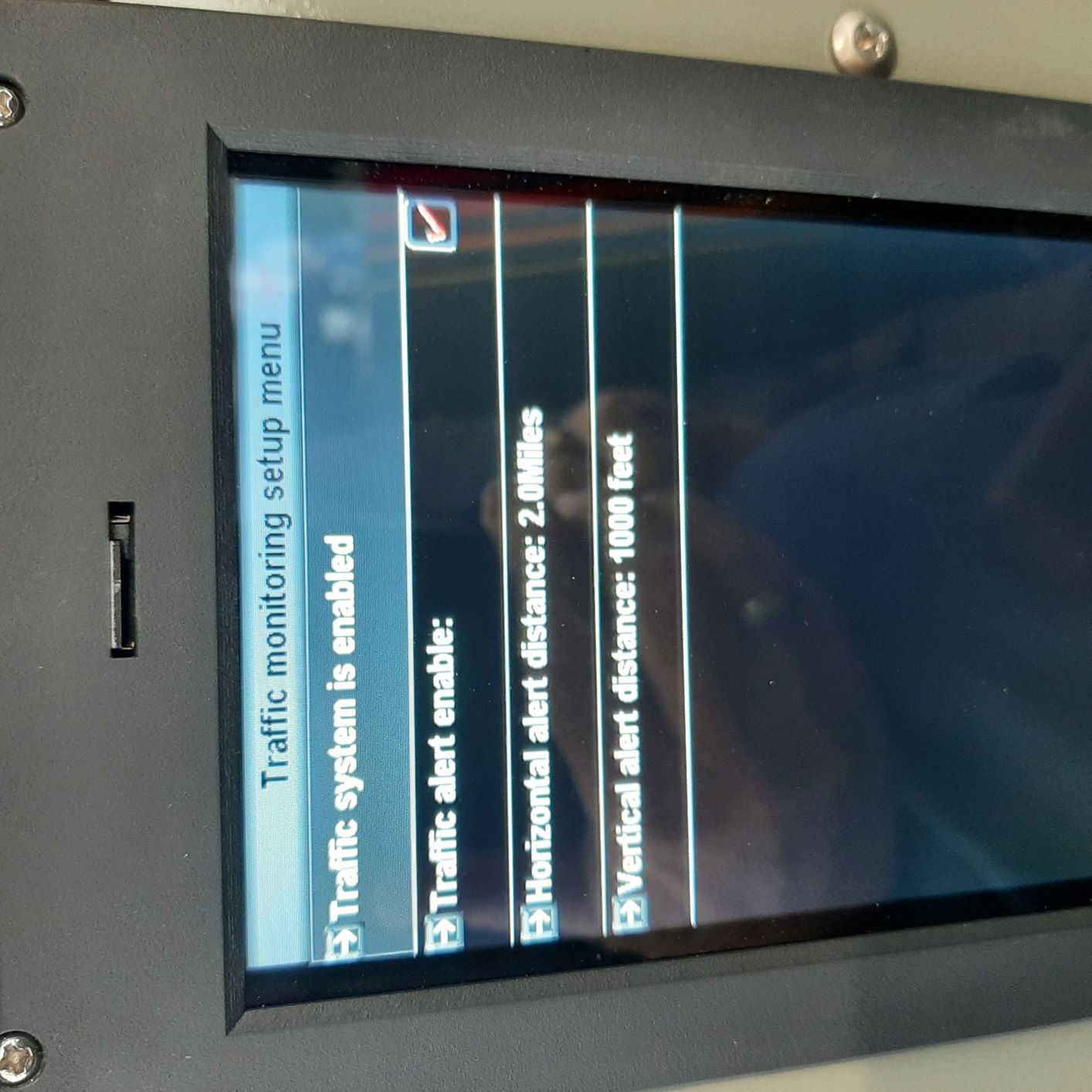

I have the traffic monitoring system enabled.

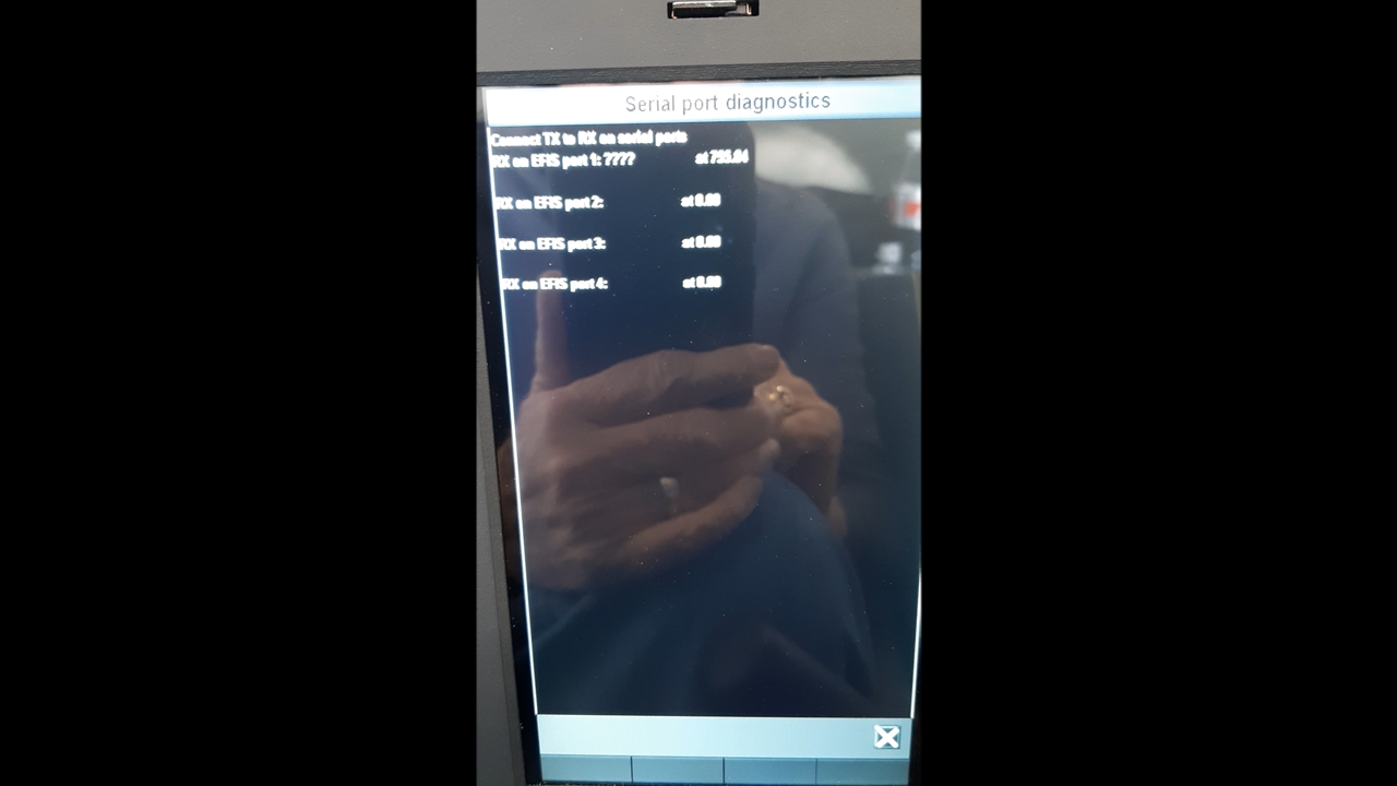

Looking at the system diagnostics for the serial ports, shows activity on serial port 1. I've attached a screenshot of the diagnostics window.

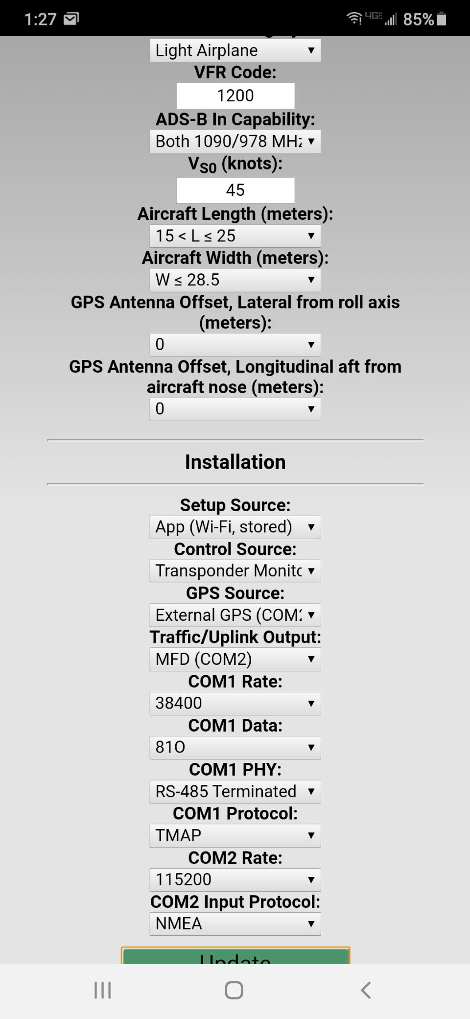

Check your ADSB setup menu and make sure your baudrate is set to 115200.

I've attached a photo of the setup menu on the Echo app. The baudrate is set at 115200.

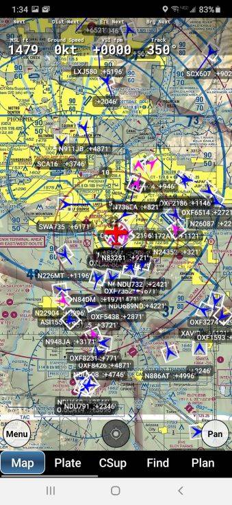

I've also attached a screen shot of the traffic in the area at the time that the MGL was showing no traffic. The screen shot is of the Avare app which is talking to the uAvionix over Wi-Fi. I fly under the KPHX class Bravo veil. It always has traffic. I also fly out of KCHD a Class D airspace that is heavily used by Asian countries for pilot training. This is why I need the MX1 to display traffic.

I've also attached screenshots of my ADS-B setup on the MX1.
