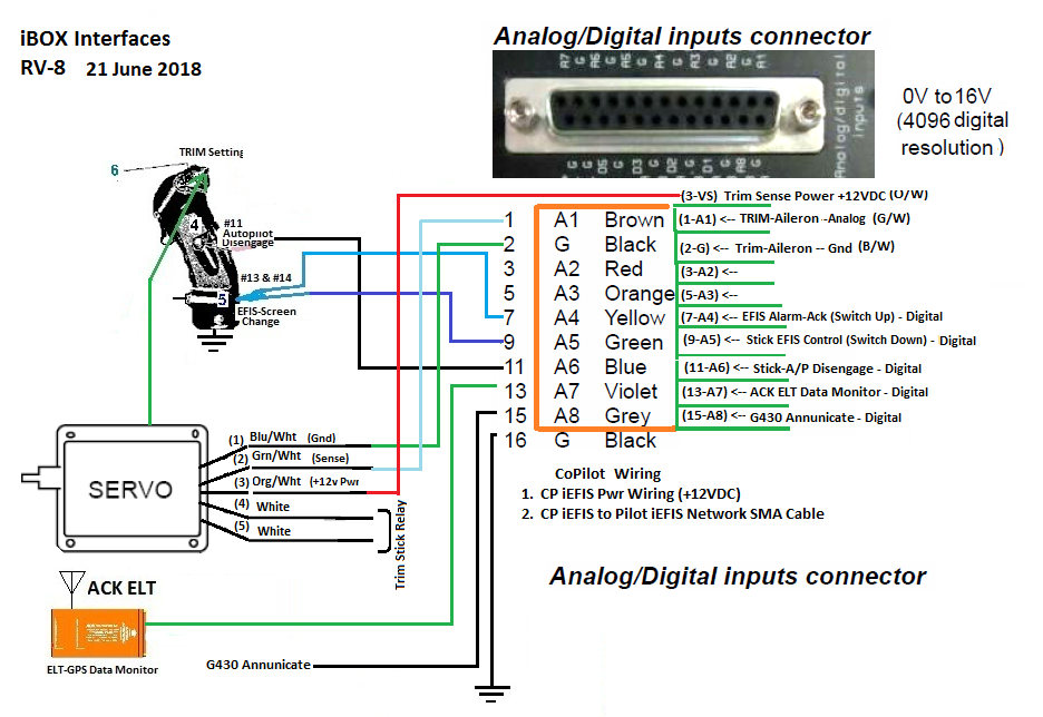

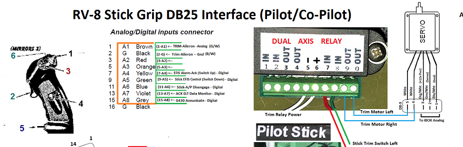

Following is my wiring for the Roll Trim, Pitch Trim works the same, My pitch trim is wired into a SP10 that controls both Flaps and Pitch trim, so has a different setup. Hope this helps. I have to reduce the Schematic resolution to get it to load on the forum, but can email directly if you send me your E-Mail address (if needed).
Cecil
Cecil
- RV8_StickGrip_DB25_Interface Wiring_29 Jan 2019_LowRes.png (234.29 KiB) Viewed 4934 times
- iBox Roll Trim Wiring
- iBOX_Analog_Digital_ Wiring_21 June 2018.png (212.85 KiB) Viewed 4934 times

First off thanks for replying. Your setup looks almost like I did. Except mine is for pitch trim and they recommend analog 2 for the input. (I think that's right without looking it up ). I also have a relay deck and I have the orange wire going to 12 volts. The only difference is the ground wire. I just ran it to ground. Could that be the reason I'm not getting any readout at all in the setup menu? trim motor runs and goes up and down. Maybe bad wiring connection on the sensing wires? This is driving me crazy.

I would say yes, it needs to goto the iBox Analog Gnd for that Sense Input. At least that's what i did and have had no problems with this.

Success at last. that was the problem. Had to put the ground in the analog input plug. Wow one more problem solved. Thanks for the help everyone that replied.
