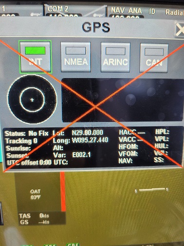

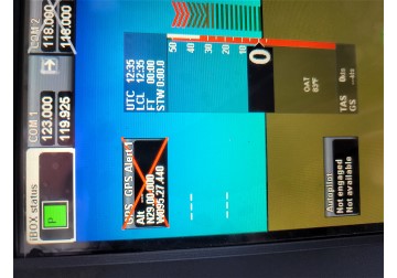

I went and took a couple of pics of my screen. It says no GPS fix?

I'm thinking my GPS antenna must be bad? I mean there is only the cable to onto the Ibox, right. What could be wrong? Its not picking up any satellites. What else could it be. Is there a way to test the antenna?

I'm going to move the antenna and see if that's the problem. I don't think it is, but that will eliminate that. This is getting very frustrating trying to figure this thing out. Ok update. I moved the antenna outside the aircraft. No change. I put it back and made sure its grounded with the mounting nut, no change. Its not receiving any GPS signals at all. Just keep getting no fix. And in the log it says start up GPS error code 1. Anybody have any idea what is the problem. ??
