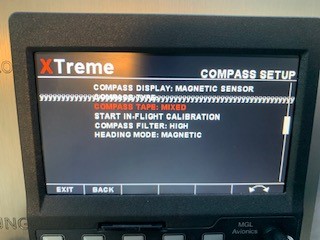

since the new update on FW 1,37 our COMPASS SETUP shows
YYYYYYYYYYYYYYYYYYYYYYYYYYYYYYYYYYYYYYYYY
Do you have any sugsetions to fix this ?
COMPASS SETUP
COMPASS SETUP

I think you upgraded from a very old version. Write down your important settings and then load default settings. This will make it like a new unit from the factory. This should sort out the issue.

update to firmware 1.36 worked and was successful.
Good news, Thanks for your assistance-
