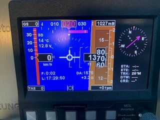

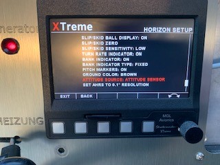

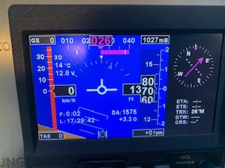

Hello,
we have a MGL Avionics Stratomaster XTreme - ATTITUDE Source Attitude Sensor
Since last Start - our Horizon is spinning - and any calibration did not work
Do you have any sugsetions ?
Thanks in advance -
Spinning 1
Spinning 1
Spinning 2
Spinning 2
HORIZONE SETUP
HORIZONE SETUP

Re: MGL Avionics - ATTITUDE Source - spinning Horizon
Post by rakop »
I just found this happen on Enigma last week when try to change its horizontal parameter. Then I change parameter of bump factor and slew factor from medium to low, it can stop self rolling horizon. This may help.
