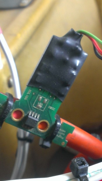

I have included a pic of the MGL Amp sensor I have on my plane, not sure if MGL has supplied other styles of amp sensor.

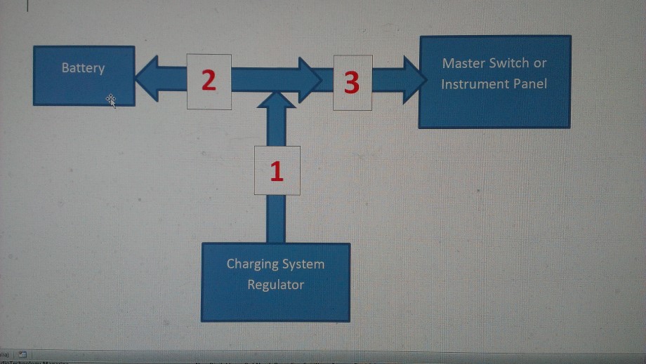

Where my amp sensor is attached to my electrical system at position 3 in the diagram below, it is on the main positive wiring to the planes master bus and switch, this suits my situation needing to know what my maximum amperage draw is from my aircraft's charging system, as it's limited to 17 amps continues and I like to keep a check on this current draw.
Yes your right if you are thinking, if I don't have another amp meter wired into position 2, you may not know when your charging system has failed unless you are very aware what your system's normal charging voltage is.
MGL Amp Sensorv2.jpg (36.85 KiB) Viewed 7407 times
Placement of MGL or Other Amp Sensor
What Amps are you reading if you put an Amp Sensor in these wiring positions.
MGL Amp Sensor Set upv2.jpg (112.77 KiB) Viewed 7407 times
1. The Sensor placed at wiring position 1, will show the number of positive amps coming from the charging system going to either the Battery and/or the Instrument Panel System if turned on and should show no negative amps.
2. The Sensor placed at wiring position 2, will show the number of amps going to and from the Battery. This is the normal position for an amperage sensor. You will see both positive and negative amps flow to and from your battery.. Like when your aircraft system is charging your battery or you're on the ground pulling power from the battery.
3. The Sensor placed at wiring position 3, will show the total amps being drawn by your plane’s electrical system. Normally you should only see a negative amp flow at this position, if you see any positive amp flow, the most common reason is that the amp sensor's orientation is incorrect.
So as you can see depending on where your amp sensor is position in your electrical system, it will give you different amp reading for different things. So before you do anything, I would try to work out work what position your sensor is wired into your aircraft's electrical system.
From what you have said and that you feel your alternator is charging your battery, my guess your sensor is wired into your electrical system at position 3, so it's only showing your total amperage draw, if this is the case, it's working as it should for that position and will not show any positive amps.
I hope this has helped.
