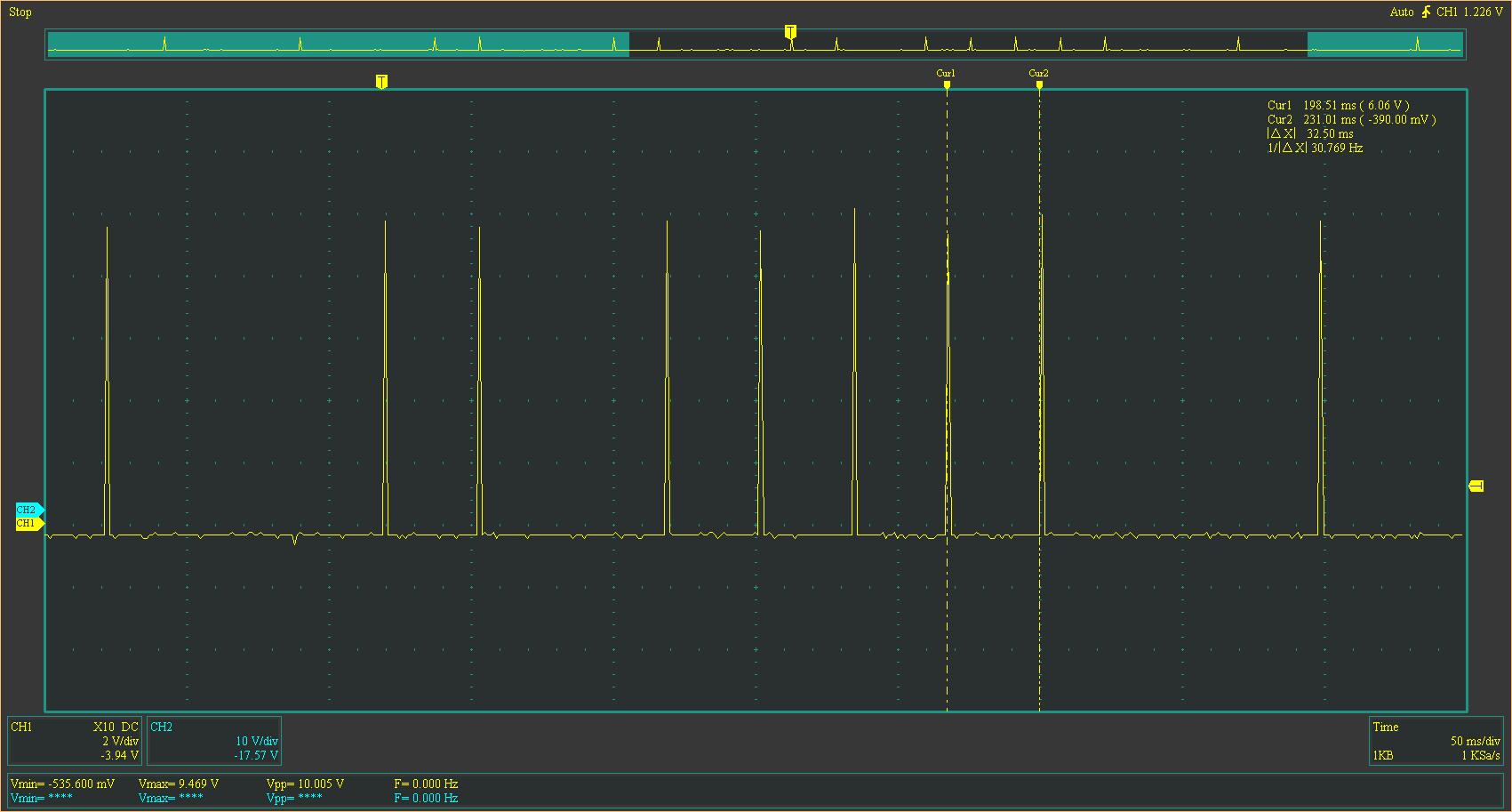

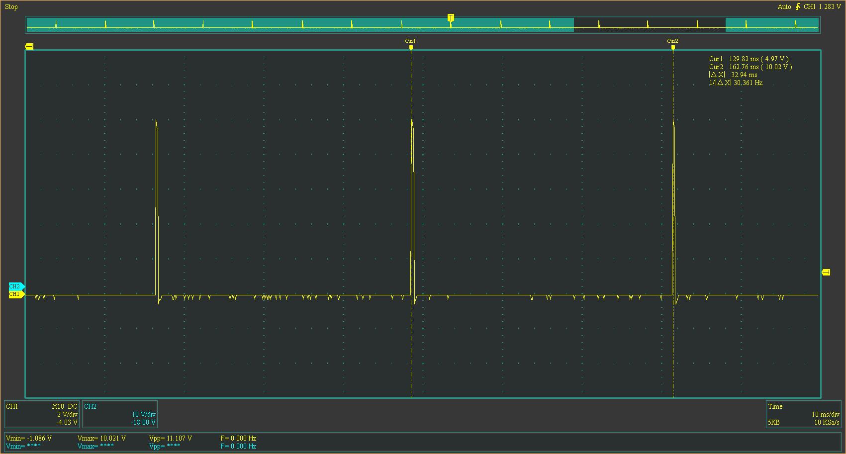

I did some test today
I checked with a scope the signal
At 1000 rpm I have a pretty clean signal (which ill send later)
With 500usec pulse at 30hz. At 10v peak

Connecting the shield to both end (on in the db9 the other at rdac gnd terminal) haven't fix my problem.
I will send the picture of the scope trace soon.
But I don't have the impression that noise is my problem here.
I have triples checked for loose connection too. (As its only over 2000rpm)

The second image seem to miss some pulse but I think it was due to my scope being too slow for that time range
- 1000rpm2.jpg (111.27 KiB) Viewed 4548 times
- 1000RPM.jpg (116.72 KiB) Viewed 4548 times
