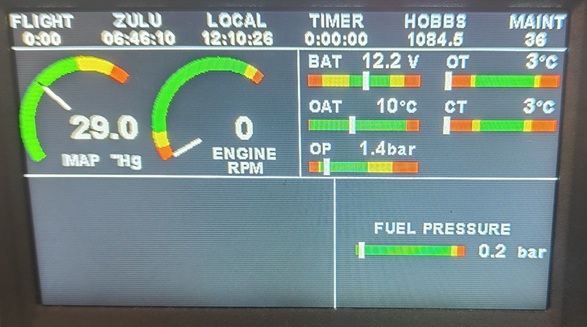

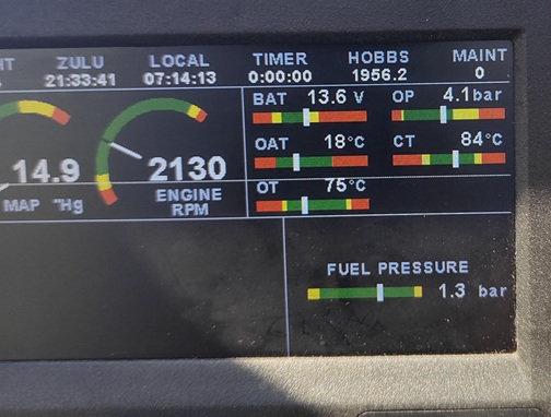

I have 2 aircraft using EMSv1 and they both display the same parameters but in a different order. Rearranging them to be the same order has defeated me.
I have tried to use the EMS G2 Simulator & Screen Designer but soon discovered it doesn't work with G1 displays.
Is there a G1 version of the Screen Designer? Is there a way to reorder the displayed parameters?
As you can see OT and OP are transposed between them and I would really like them to be in the same place on both displays.

EMS1 vs EMS2
EMS1 vs EMS2
- IMG20250528103904.jpg (114.56 KiB) Viewed 479 times
- IMG20250520151230.jpg (113.27 KiB) Viewed 479 times
