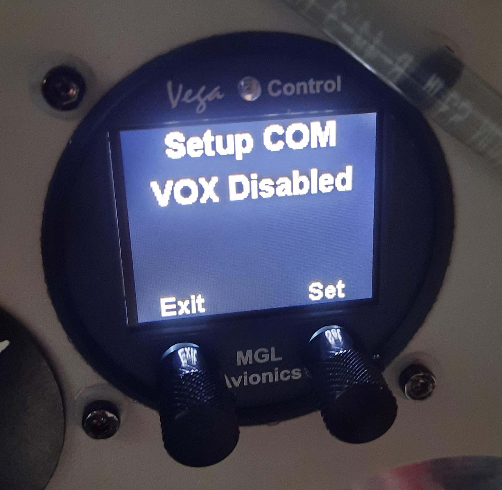

Hello all,
I'm trying to enable VOX on my V16+vega but when I get to the setup page for it, it is frozen in "VOX disabled" mode. I try to turn/push/push+turn the "Set" button but nothing changes. All the other setup pages seem to work fine; the problem is really specific to this page.
Has anyone got a similar issue?
-Dimitri
Re: V16 VOX disabled
You have setup your radio for a hot microphone (the V16 is expecting a switch to turn the microphone on or off).
Post by sparxfly »
In the COM setup menu-
  • Intercom switch is mike
  • Intercom switch is playback
Select if you would like to use the intercom switch
input as a microphone activation switch (this
option disables the VOX)
or if you would like to
use this input as playback request for last RX.
Stuart
NZ MGL dealer
