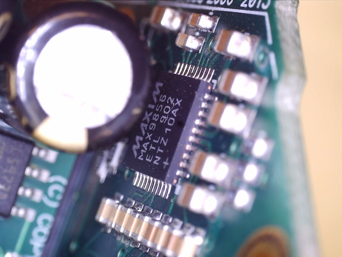

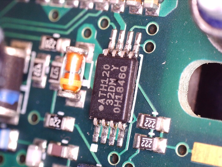

My V10, during one of my last flight, it started having this same issue of losing radio audio and calls when I pressed near the flip flop button.
I turned the the V10 off and then back on and the V10 would come to life again, if I change the frequency via the EFIS we would not have the problem of the audio disappearing.
I have just read Loopy's last post and now thinking from your description, I am thinking I have Identify the wrong Chip(ATH120) in the pic just below.
I now think Chip (MAx9853 Audio Chip) in the pic below may be chip I need to reflow, But both chips look ok under the microscope. But I guess you don't know until you can get a good look at the back number of lugs after we remove the 90 Deg. PCB off.
Identifying 2nd V10 Chip to reflowV1.jpg (89.69 KiB) Viewed 8713 times
Re: V10 odd issue
Hi everyone,
I finally found time to get my V10 radio back together.
Firstly, as talked about by Loopy in his post, so Loopy and Rainer, thank you for your experiences.
I took off the PCB Board that has the larger capacitor and stops you from getting a good look at all the pins around the Chip "mx9856".
What I found under my electronics microscope is that all the mx9856's pins looked to be well soldered.
But what I did notice under the scope before I removed the PCB board, the multi pin connector that solders it to the main board, it looked like some of those pins could have joint issues.
So once I could get a good look at the mx9856 chip under my electronics microscope, I could not see any type of soldering issue of it's pins and all the pads/pins looked really well soldered and could not see any type of pin movement when testing each leg.
So I though maybe my issue was with the board to board soldering of the PCB Board multi pin connector.
So I re-soldered this board's pins back to the main board and tested the V10, could not make it have any audio issue, by pushing or gently flexing the PCB boards around that area of issue in the V10.
So back into the plane and doing a number of frequency cycles, flip-flop, entering new frequency and then a flight test.
The V10 is operating perfectly, so in my case it seems the PCB Board connecting pins to the main board my have been where my dry solder joint issue was.
But time will tell.
JimJab.
