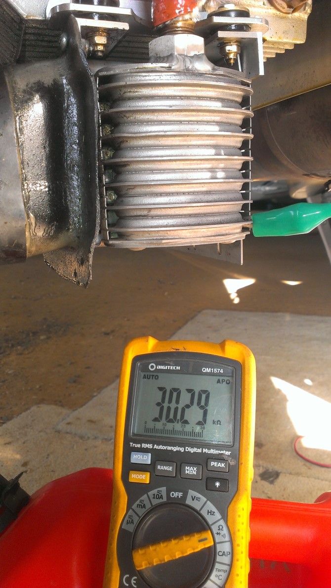

It has taken some time for me to check this out with a multimeter, why I don't know as I spent less than 20 minutes checking out OHMS reading of different parts of my aircraft components earthing back to the engine block to see what and how well things were earthed.
This picture below is of the oil cooler and is of the multimeter OHMS reading back to the engine block. This oil cooler had no earth strap to the engine block and with its rubber mounting is somewhat insulated from the engine block.
So it had a very high OHMS reading to the engine block and of interest, I found the Carby had an earth strap back the the engine block.

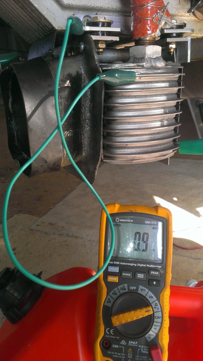

I put a simple bridging test clip from the oil cooler to the engine block, to show how well the oil cooler can be earthed with an earth strap.
So as part of my search to fix my GPS issue, I will make up an oil cooler earth strap to the engine block, like the Carby already has got and see where this leads us.

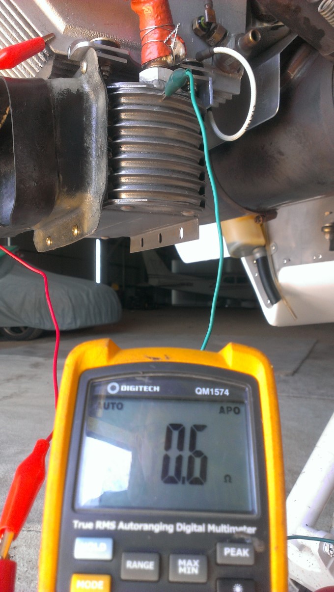

Here is an interesting example where you think there should be a good electrical connection between two parts. But this pic below shows a rivet that has a very poor electrical contact between the rivet and firewall, the cause could be a small amount of oxidization or corrosion between the contact surfaces and this can happen for earthling strap connectors as well.
