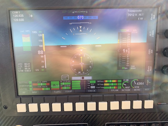

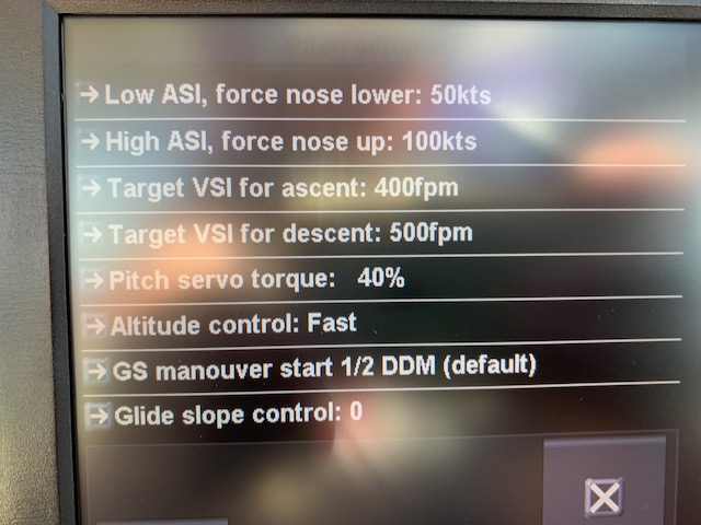

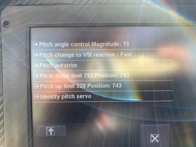

Sorry, forgot the A/P engagement screen but the A/P was in HDG (Track) Hold and Alt Hold.Would you be so kind as to show:
A screen shot of your pitch control setup menus contents.

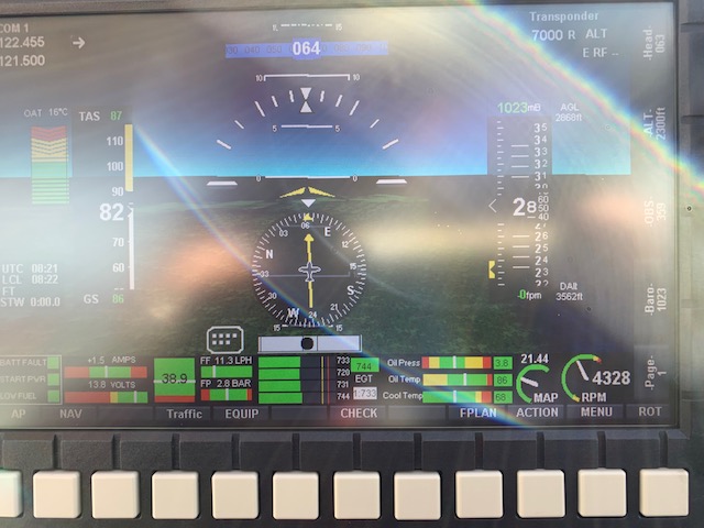

Today, it was so calm I think I would have had better altitude control if I'd have left the pitch channel disengaged and just left it trimmed level (as I did before engaging the A/P).
Photos below show it's great at ignoring the selected altitude both high and low
It's just all not very good at all and if you think I'd spend another £500 fitting an SP-7 you're having a laugh. Another EuroFOX owner I've spoken to did exactly that and said it made no difference whatsoever to the vagaries of attitudes displayed nor the abilities of his A/P.

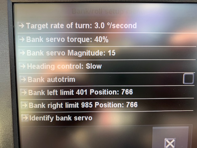

Have some more photos

Your pitch magnitude setting is unusually high. Not saying it is wrong but usually you would be around a 7 or so.
I can't see the flight director on your screen. Can you please enable it in your 3D setup menu. The flight director will show us what the AP wants to do.
Please also a screen shot of the AP popup screen where you normally engage the AP - I would like to see the Vertical mode selected.
Your servo torque settings are pretty low - I hope the servos actually have enough force to actually control your stick with those settings. In a similar aircraft to yours I tend to have settings of 80% for both.

Your pitch magnitude setting is unusually high. Not saying it is wrong but usually you would be around a 7 or so. I have had it set on various settings, both higher and lower and found it makes little difference. I'll put it back down to 7 and see what happens
I can't see the flight director on your screen. Can you please enable it in your 3D setup menu. The flight director will show us what the AP wants to do. I don't ever recall seeing a FD option. I'm sure it is there, just I rarely go into that setting and, if I do, it's normally to turn the SV on or off. I'll see if I can find the FD option and turn it on. As you say, at least it'll tell us what the A/P is being told to do.
Please also a screen shot of the AP popup screen where you normally engage the AP - I would like to see the Vertical mode selected. WIll do when I fly next, although the FMAs (as blatantly copied from my day job) at the top of the screen, show the engaged modes.
Your servo torque settings are pretty low - I hope the servos actually have enough force to actually control your stick with those settings. In a similar aircraft to yours I tend to have settings of 80% for both. Not a snag, I'll whack them up. I've tried various settings on those as well but didn't make any difference.
