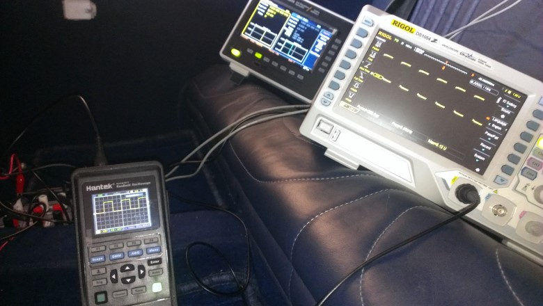

A few days ago I got the chance to use the Hantek 2D72 hand held Oscilloscope/Multimeter/Wave Generator it seems to be a solid unit for it's money.
But there is a problem, the MGL EFIS could not detect the test pulse signal from the handheld unit.
So once back on the ground, I did some further testing of the Hantek unit with my 240v test gear, I found the Hantek could not generate a pulse voltage Peak to Peak over 2 volts, which is not high enough to be detected by my MGL EFIS's.
After some testing I found the test pulse signal needed to be over 2.7 volts before the EFIS could detect the pulse wave and calculate the fuel flow. So if I want to test the system in the air with a pulse generator, I would need a handheld test generator that can generate at least a 5 volt square wave peak to peak.
That's a stuff up on my part, but I found the Hantek 2D72 oscilloscope function to do the job in the air and can give you a readout of the pulse signal frequency once the Frequency counter is selected in the menu.

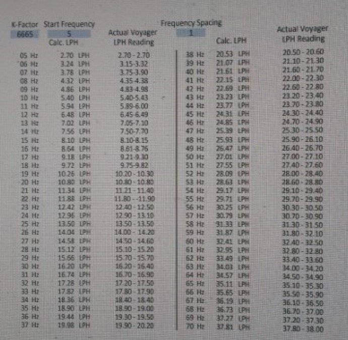

I have back tracked a little with this post.
I did this chart up, in the first column is the Pulse Frequency in Hz. and in the second column what the Mathematically calculated LPH for that pulse frequency would or should be.
The third column is the recorded EFIS's LPH reading when testing my Voyager EFIS's with a 5volt DC square wave pulse, using my aircraft's fuel flow senor's wiring and my Sine Wave Pulse Generator. My EFIS's was set to a Fuel Flow Sensor's K-Factor of 6665 which was most accurate when I bench tested my new MGL Fuel Flow sensor.
I did quite a bit of testing of the Voyager EFIS's LPH readings for any given test signal frequency and when judging it against the Data Sheet mathematically calculated LPH figure, it all seems to be pretty accurate.
During this testing, the aircraft was on the ground, engine not running and other avionics were turned on and off, including the electric fuel pump, we saw no changes to the EFIS's LPH reading as avionics were turned on and off, the electric fuel pump added no EMI to the sine wave generator pulse signal. But remember the fuel flow sensor was not connected to anything during this testing.
We then did this all again with the engine running and saw little change to the accuracy of the EFIS's LPH readings against the test frequency readings.

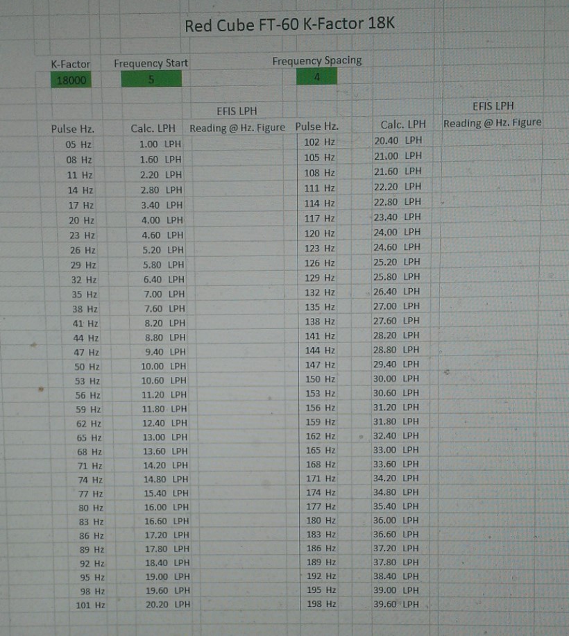

I have edited this post to add another Data Sheet to show the mathematically calculations for a FT-60 Red Cube using a K-Factor of 18,000 and what the calculated LPH would be for the given Frequency. Hope this will help some one with Scope checking their fuel flow and pulse frequency.

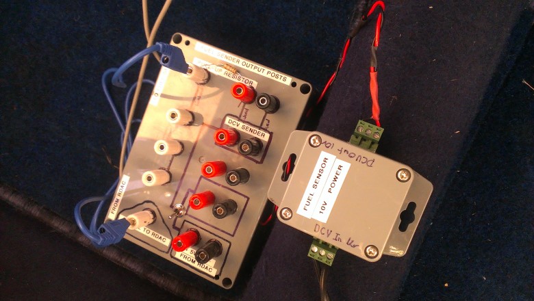

I took to the air yesterday after inserting my test box into the Fuel Flow wiring, so I could switch between the RDAC 5 volt DC power supply and the 10v DC regulated power supply with a flick of a switch.
I connect the handheld oscilloscope to the signal wire at the RDAC to see the pulse signal at the RDAC.
The 10v DC regulated power will not fix every issue you could be having with your fuel flow system. Like I found, having a stuffed Fuel Flow Sensor that needed replacing.
The handheld oscilloscope worked Ok, the 10 volt DC pulse signal had a good solid square pulse and frequency. The RDAC 5 volt DC pulse had a rising edge signal that was rounded and the pulse frequency seemed less even.
The RDAC 5 volt DC pulse signal still worked ok as I saw little change in the EFIS's LPH reading when switching from the 5v DC to the 10v DC pulse signal.
But, I do think the 5v DC power supply does not have the square wave voltage head room (an audio expression) needed to overcome a margin of electrical inference we may get with the Jabiru and this can lead to signal degeneration and inaccuracies with the EFIS's LPH readings.
I also think when comparing 5v to 10v, I also feel Steevo is right with his 10v DC regulated power supply to power the fuel Flow sensor in our Jabiru's and worth the effort to get a 10v DC power supply to have a better voltage margin with any possible electronic interference and to help maintain a more reliable square wave PP and signal frequency to calculate the LPH reading throughout the rpm range.

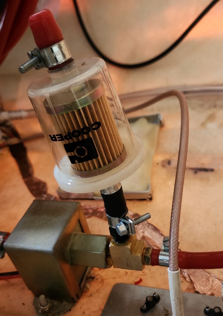

I eventually got around to fitting and testing my attempt to fix this issue.
1. Moved the Red Cube to the rear, after the fuel filter
2. Connected a buck converter outputting 10v
3. Connected signal line to clean 10v and back to Rdac with shielded wire.
4. Made an anti hammer device using a fuel filter.
It is definitely more stable, still needs to be set at 27k pulses, instead of 18k where it should be. But seems pretty accurate.
Pic below

Hi Tasmag,
I think the vertical positioning of the filter would give a much better air trap and dampening effect than the way I have my dampening filter which is nearly horizontal.
Work is still getting in the way and I am still yet to complete my testing of my EFIS LPH against the calculated Frequency/LPH. I have done some testing with my portable scope in flight.
But now that I have flown a few hours since changing and adding the dampening filter, the amount of air trapped should have normalised, so testing further should be OK.
I am going to make up an inline adaptor so I can easily plug the scope into the fuel sensor plug at the sensor. That way I don't need to run the scope cable from the RDAC and around outside the cowl and back into cabin. Through the firewall gland is not an option, as it's already full and tight with wires.
Also I can leave the test cable rolled up on the shelf behind the Jab 430 seat and just pull the cable out when I want to do some further testing.
Tasmag, thanks for the post and sharing the pic of your damping filter setup.
