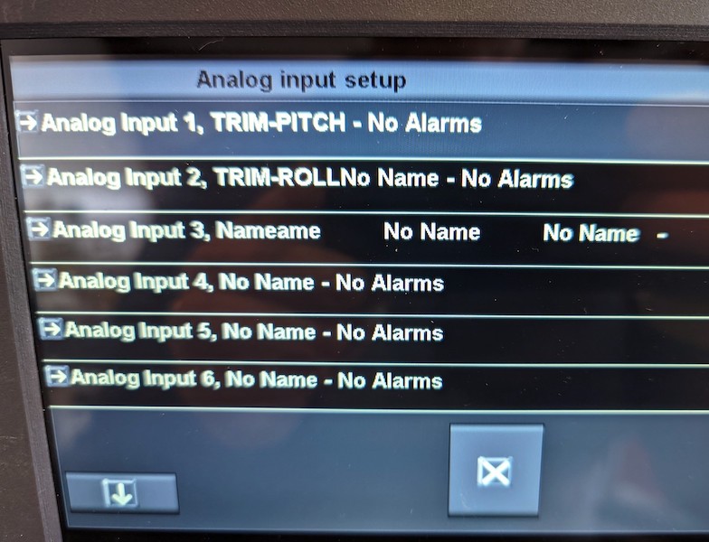

Extender: Keep in mind I was getting errors while on the bench with only power connected. So it seems to be all configuration settings and not the actual physical connections.
It's been awhile since I wired it. I'm thinking that on the MX1 it's on RS232 port 4. Also I remember that the MX1 port4 in/out markings are backwards. Took me a long time to figure that one out, and the purchase of an oscilloscope.
Only one extender. There is more information that I sent to Adam, about the analog inputs which I suppose he sent to you. Seems the analog names like to get mixed up on occation. Here is the picture. If you don't get the full description forwarded from Adam let me know.
