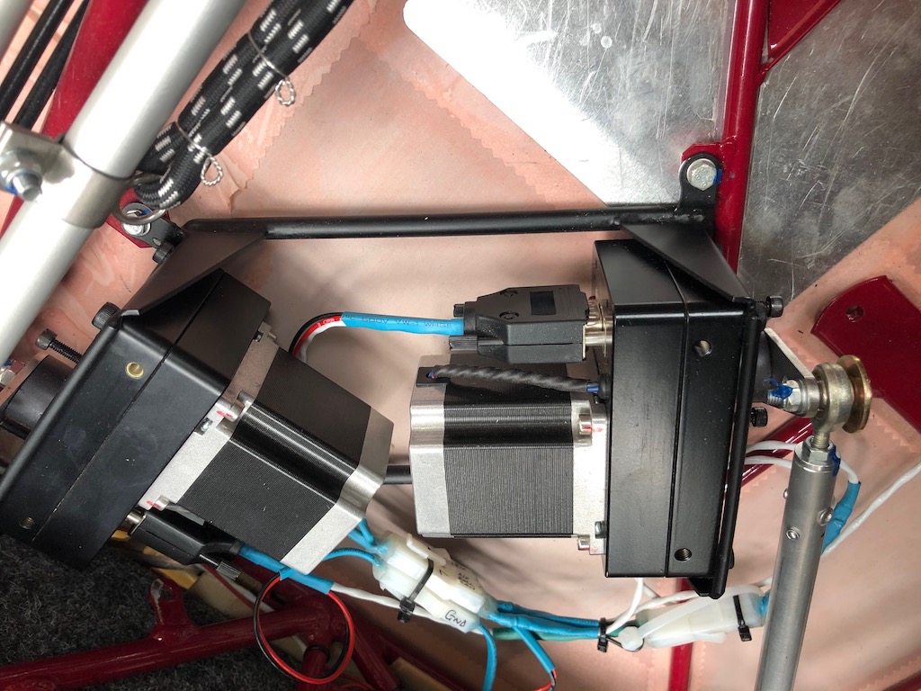

Practically all issues are related to coupling of the servos to the control surfaces in our experience.
The first thing to check is the shear screw on the servo arm - that needs to be tight. Once installation is near completion the screw should be fitted with a drop of locktight. If this is not done it WILL come loose and the AP has no chance of controlling the aircraft properly.
Similar should be done to the large grub screw in the servo boss - this needs to be tight and a drop of locktight needs to be applied so it stays that way. The forces acting on the servo shaft can be pretty big.
The AP relies on small corrections on the servo arm making it though to the control surfaces. If this does not happen you will get oscillation as the AP will forever be behind the aircraft - no possible setting you can do on the EFIS will fix that.
I would also like to mention another example: A sinus came to my attention where the pitch control was really bad. The installation was done well. When I got to see the aircraft and tried the servo test the entire floor of the aircraft would flex - the servo was mounted on a structure that was connected to the fuselage floor - and this was pretty thin to save weight. It was easier for the servo to flex the floor than move the elevator !
Look at your entire control linkage scheme - make sure a small movement of the arm WILL feed to the control surfaces and don't let gravity on a surface fool you - a small amount of play somewhere can have big consequences once it gets to the control surface. Make sure your mounting brackets etc do not flex under load.

Thanks for the reply, Rainier, but I genuinely don't think it is anything to do with the mounting of the autopilot servos or the connections. Everything of mine has Loctite and is marked to show any movement. Hopefully the attachment will show the 'cage' in which the servos are mounted and secured to the airframe. The Garmin & Dynon servos are mounted using the same hardware.

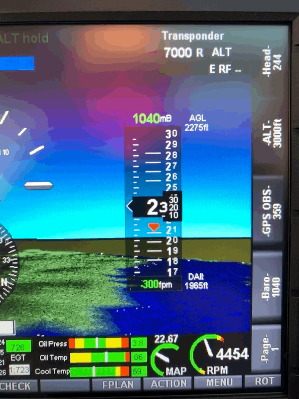

The altitude keeping definitely strays outside of 50'. I would actually be quite happy with 50' but very often I will take the autopilot out when I'm flying below controlled airspace, as I don't trust it enough to stop me straying into it. When my wife is with me I'm under orders to hand-fly because she can't stand the way it wanders around in roll.

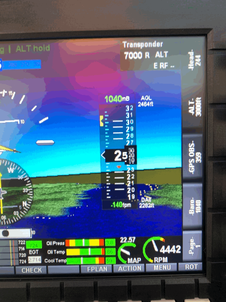

Today was so calm and smooth I could have fallen asleep. Somehow my '50ft herd' turned into +700' (from the 3000' Alt Hold) and then I got bored and disconnected the autopilot at 2100' with it still descending. +700/-900......yeah, that's close :roll:

The autopilot works; just really not very well and yesterday's dead smooth weather gave it ample opportunity to behave itself (literally smooth, smooth and zero wind). To climb 700', descend 900' and still keep going is not acceptable.

That is not what the AP is doing on its own. It's got a problem controlling your pitch. You need to sort out the mechanics as I tried to explain. If you do that it will hold rock solid with only the tiniest of control input.
In a nutshell - if the AP changes the pitch servo by a small amount and nothing happens, it will continue increasing the pitch deflection (on the servo) until something does - then it overshoots as it's too much and then it starts to correct - with the same result.
Small changes are not feeding through to the control surface.
Just as example: I had a case with a pipistrel sinus with similar behavior. Very nice installation, could not fault it and servo perfect. But what was happening - as the servo moved - the first thing that happened was that the entire floor of the aircraft where the servo bracket was mounted to flexed - without anything happening at the elevator. Only once the floor could flex no more did the elevator surface start to move. Needless to say, once that little issue was fixed - it held pitch perfectly.
Not sure how your aircraft's pitch servo is coupled to the elevator - but I am sure we have an issue here. It's always like this. In the many years I have done this it always comes down to the same thing.
