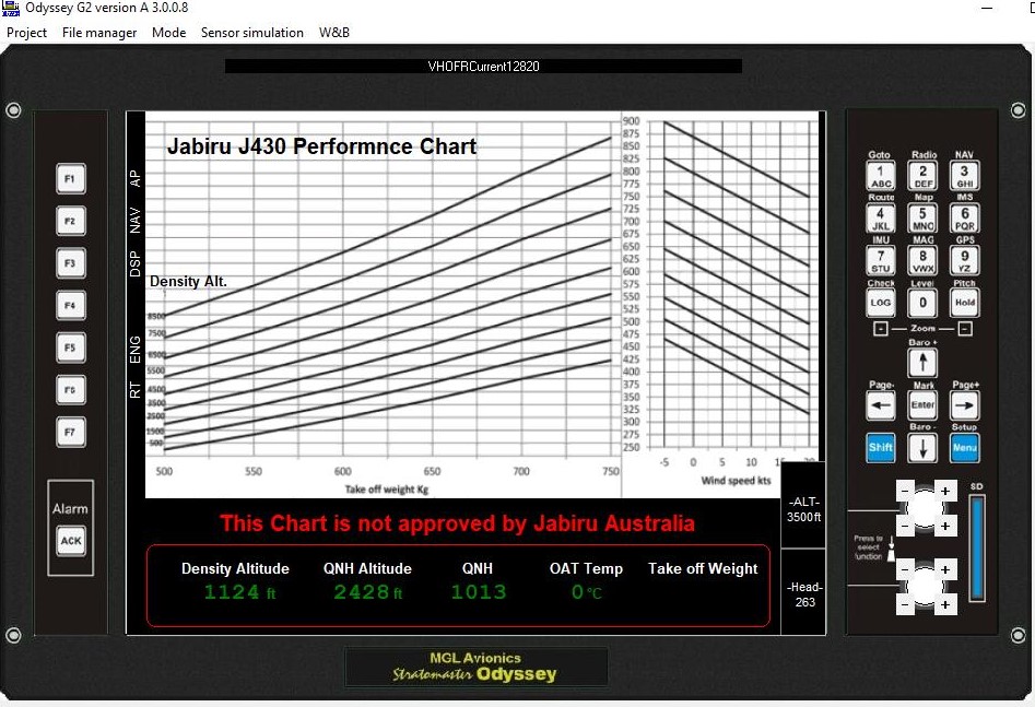

Thanks for your reply, I have set up the my W&B, so what I would like to do now, is add my current gross weight from my W&B page to my P-Chart screen as in the pic.
I am not sure if there is a design component that will allow me to insert my current aircraft weight from my W&B into a my P-Chart screen design, if so I have not found it.
Hence the question to Rainer, but if you know if this can be done or know how to do it, I would be very much appreciative of any help.
P-Chant for Jabiru 430
PChart ScreenShotV1.jpg (170.95 KiB) Viewed 4046 times

No such a screen designer item does not exist - the calculations are only done when you actually look at the W&B display.
