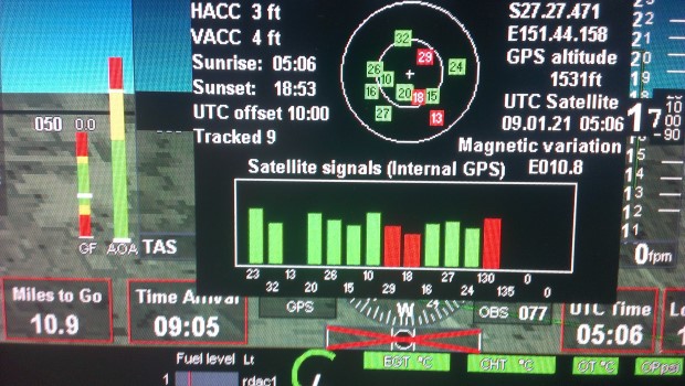

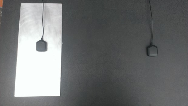

With the panel out of the plane and having two Voyager EFIS's. This has given me the perfect opportunity to compare the GPS signal strengths with one EFIS having ground plane antenna and the other EFIS without. I did said in a previous post, my Voyagers GPS signals had always been rock solid with out having antenna ground planes.
So before I started this bench test, I did swapped the antennas and EFIS around to check that each were reading about the same GPS signal strength on each antennas and each EFISs showed the same. I also tested the distance between the antennas to see how this may affected the GPS signals. This all took some time as it's all about averaging the satellite signal strengths as they do change.
So here are some pic of testing the antennas with and without a ground plane, the pic shows the antennas about the same distance apart as when in my plane, there seems to be no noticeable signal issues at this distance apart.
Well there is an old saying, "“You Don't Know, What You Don't Know”.
Having a plastic plane (Jabiru) I think for me it's worth the effort to make up some ground planes, as it looks like you can get an extra 10-17% GPS signal strength improvement. But, if I was pretty busy, I would leave it and just go flying.
So the next step will be to test if the thickness of the a ground plan material will affect the signal strength. As I would like to use a thin tinfoil or PCB copper sheeting on the inside of the Jabiru instrument panel cavity as the ground plane.
Sat Signal Without Ground Plane
Testing antennas at the same time with a Ground Plane and one without.
Sat Signal With Ground Plane
disclosure; you my notice these picture are not taken simultaneously or at the same time of day for each of the GPS screen shot. Unfortunately the matching simultaneous picture were too blurred to use on the forum. But as I did this ground plane testing over a few hours, the two pic I have posted gives a fair representation of the difference between a ground plain signal strength and not.

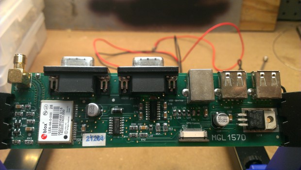

So I opened up and removed the GPS /USB Board from the EFIS, in my situation I had the USB power upgrade done so I had some de-soldering to do, before I could get the board out. I had a good look and then a good clean and good look again at the board's components etc.

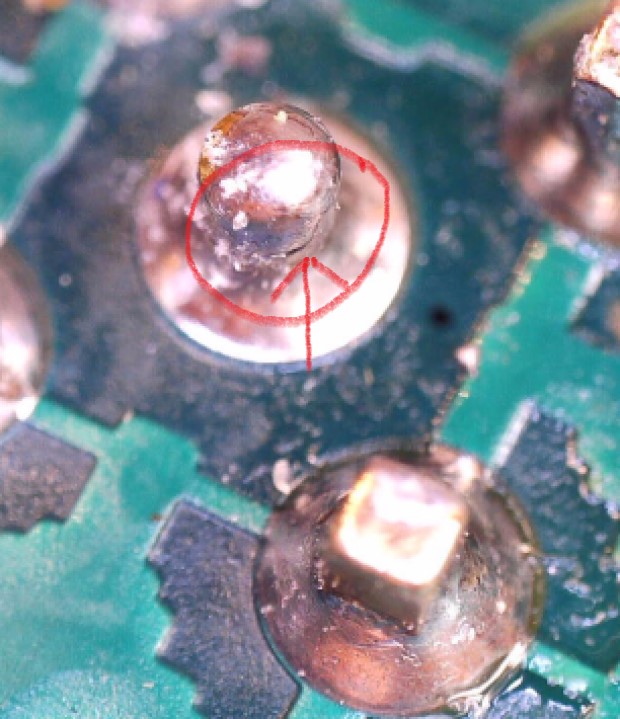

After having a good look around with a Electronics mag scope, I found what could be causing the "GSP not Available" and "GPS Available" problem. As you will see in the pic, there is a very small crack that does go around the SMA antenna pin and there is a crack on one of the support/ground pins as well. So I re-soldered all the SMA pins to the PCB board.
GPS SMA Antenna Pin Crack.jpg (98.68 KiB) Viewed 36711 times
