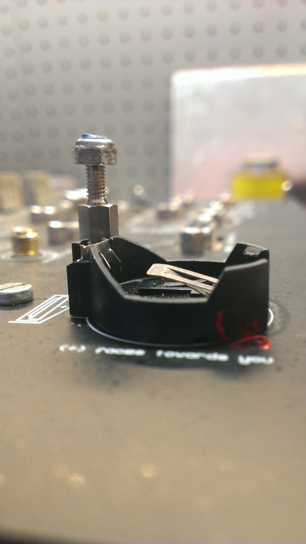

I found my Hobbs and Maintenance Hours between flights would be lost at times and on other days I would go to the plane and all was good and still had the Hobbs hours. A bit of MGL forum searching found that the Button Battery would most likely be flat and need replacing.

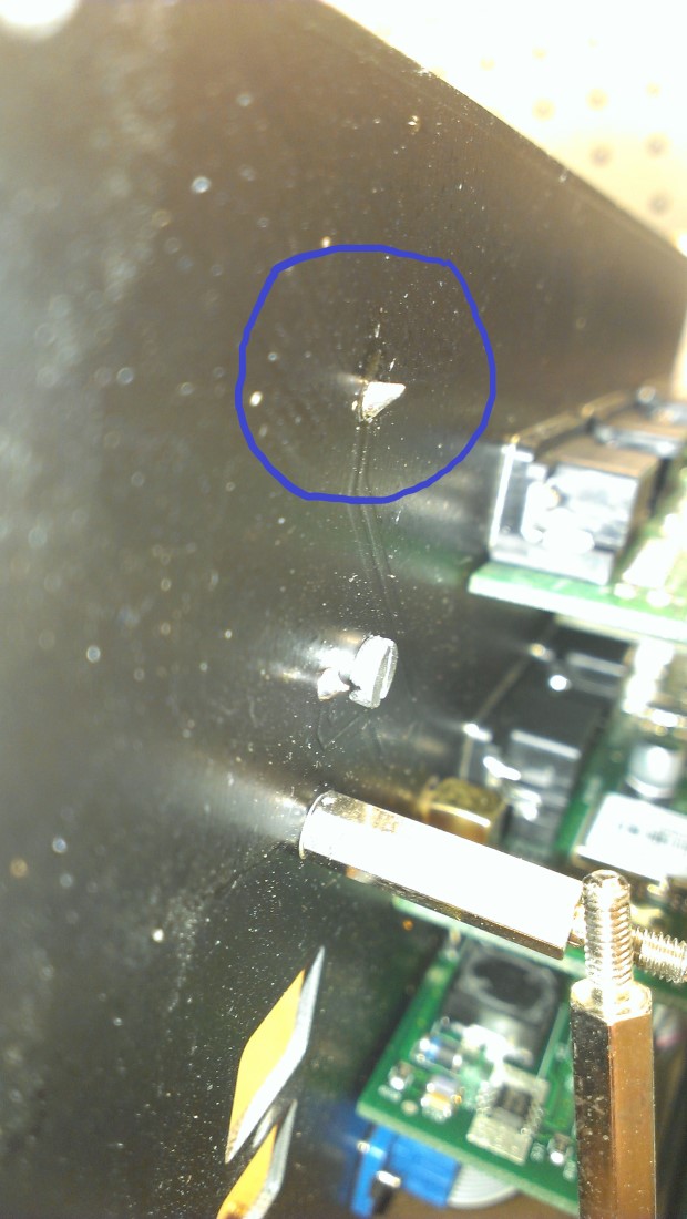

But when I removed the cover to the button battery. The first thing I notice was one side of the Button battery holder was sitting slightly off the surface of the board and the center battery tab in the holder had no spring in it and was sitting flat. As I tried to wiggle the Battery holder the solder pin popped out of the board and solder hole.

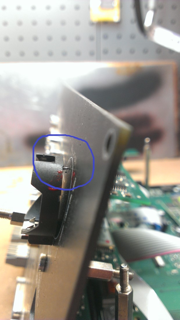

I thought the battery holder pin looked very short and when looking at the next pic of the solder joint on the other side of the board, it looks normal. My guess the pin cracked out from around and under the solder joint.
I did sourced a new button battery holder locally and all that was needed was a basic re-solder of the two pins that held the battery holder in place. Notice how the center battery tab now sits up and has a spring in it.
